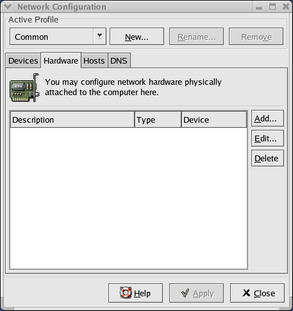

The very first step to setting up wireless networking on Red Hat 8 is to see if your Red Hat installation recognizes the wireless network card. Plug your PCMCIA wireless card into your notebook and boot up Linux. After logging into your user account, click on "Network" under the "System Settings" menu. Your action would bring up the "Network Configuration" dialog. Click on the "Hardware" tab.
If your Red Hat installation recognizes your wireless network adapter, it would show up in the box. You are also very lucky if it recognizes your hardware, so skip to step 3. But if Red Hat doesn't recognize your hardware, then you'll have an empty box like what I got (see screen shot below). All is not lost, perform Step 2 and you will have a chance to get it to work.

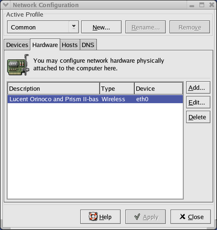

Armed with these knowledge, I was ready to hack the PCMCIA card identification configuration so that Red Hat would recognize my RangeLAN-DS card. First, I su to root so that I can execute "cardctl ident" in the sbin directory. I wanted see what the RangeLAN-DS identify itself as . . .
Socket 0:
product info: "PROXIM", "RangeLAN-DS/LAN PC CARD", ""
manfid: 0x0126, 0x8000
function: 6 (network)
Armed with these information, I added the following lines to /etc/pcmcia/config:
card "Proxim RangeLAN-DS/LAN PC Card"
manfid 0x0126, 0x8000
bind "orinoco_cs"
The above lines tell Red Hat to associate the RangeLAN-DS card with the Lucent Orinoco and Prism II-based PCMCIA Wireless card. You see, the RangeLAN-DS card, like many wireless cards, is using the Prism II chip set. So it works just fine with the Prism II driver.
After changing the configuration file, reboot the computer. Open up the "Network Configuration" dialog box again to see if Red Hat recognizes the card. In my case, Red Hat successfully recognized the RangeLAN-DS wireless adapter and associated it to the Prism II-based driver (see picture below).
