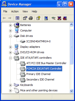

I took the Seagate 5GB ST1 Microdrive out of a Rio Carbon and inserted it into the PCMCIA slot on my Windows XP notebook, but the drive does not show up in "My Computer". So I looked at the Device Manager and it shows the "PCMCIA IDE/ATAPI Controller" driver, but no driver for the disk drive itself.
Is there a way I can get the drive to show up?

Chieh, it would not show up as a drive in the explorer right out of Carbon.
The reason is, Carbon does not format the drive with FAT. Instead it emulates a portion of disk as a FAT partition. More specifically, the location of partition tabe and FAT tables on a drive pulled fresh out of working Carbon is not the standard one.
However, you can format the drive in Windows and then on it will show up as a drive. You cannot use this Windows formatted drive in a Carbon!

Thanks for the tip on how Rio Carbon deals with the partitions. So how do you format a drive in Windows if it doesn't show up?
Fri, 17 Dec 2004 12:55:03 -0800
Computer Management is the tool. Right click my computer icon and select Manage.
Inside the tool, choose Disk management. You will see a 4900 odd MB drive showing up (beware, it will take more time than usual to show the drives because it will try hard to understand the Seagate drive's format which is non-standard). Right click that drive and select format!
