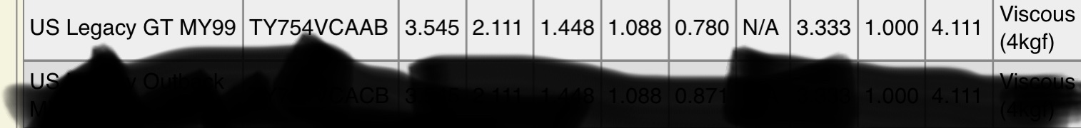

I see in your chart that an '01 Legecy Outback (US) with a 5 speed has a 3.9 final drive ratio, and an '02 WRX with a 5 speed also has a 3.9 final drive ratio. Is the final drive ratio the rear differential ratio? If not, what are the rear differential ratios of each of those vehicles? I am putting the '02 WRX tranny into an'01 Outback, and need to determine if I have to change the diff.

Just FYI, the 01-02 Outback 5MT (TY755VC2AA) has a 4.11 final drive, not a 3.90 final drive. Source: service manual for the 02 Outback, plus I opened one up and checked. I attached a page from the 2001 Outback manual; the 02 Outback manual says the same thing.

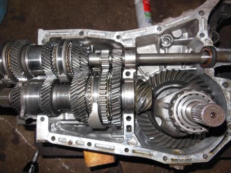

I opened TY752VBAAA twinturbo gearbox and there was 3,9 final drive. I have antoher TY752VBAAA gearbox also, I will check that one also soon.

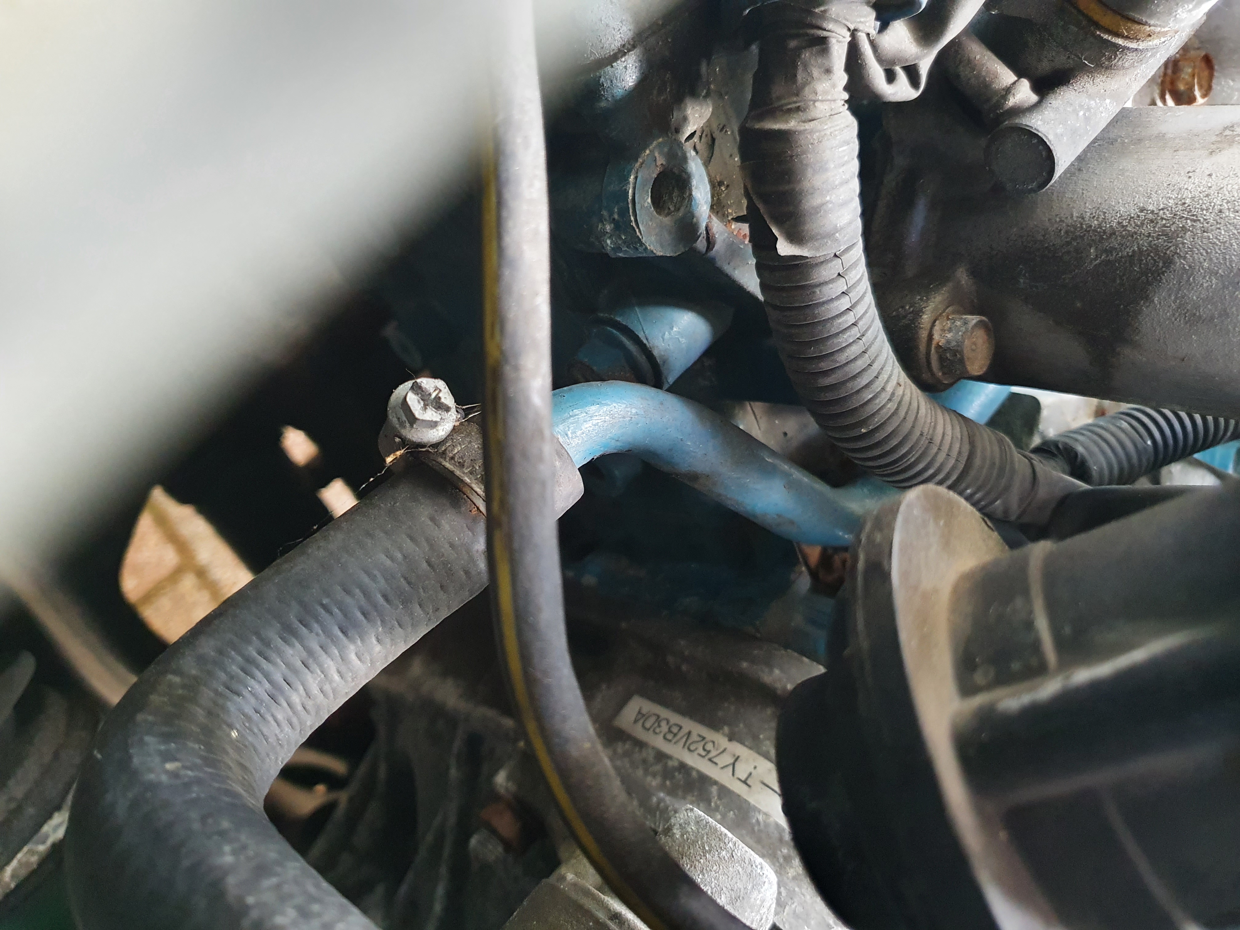

Hi I have a gearbox ty752vb3da, think its out of an RA , its sitting in a 1997 impreza wrx estate ,could someone tell me if the drive shafts are the same with this gearbox as to the original gearbox,as need 2 driveshafts thanks ⁸
