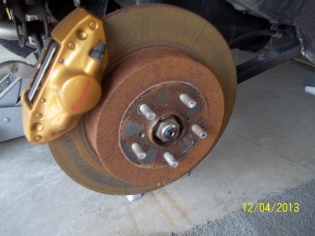

i bought a pair of these rotors 6 months ago after installing rear Brembo calipers on my '03 WRX. performance of these rotors was fine but after a few months of winter driving on salted roads they had severe rust and looked like they were about 10 years old.
i removed the rust with a 3M sanding disc on a drill, masked off the wheel studs and the swept part of the rotors and painted the un-swept areas with hi-temp (1,200 F) stainless steel paint (Steel It) which i bought from McMaster Carr. It worked great and the rotors look good as new now. so if you buy these and drive where there is salt on the roads you need to treat them to keep them looking good.

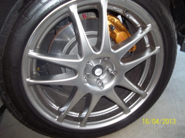

Yeah, it looked pretty nasty! Here's what they look like after sanding and painting. I had some old pads on in case the paint transferred to them but saw none on the pads when i swapped in my new Brembo pads:
