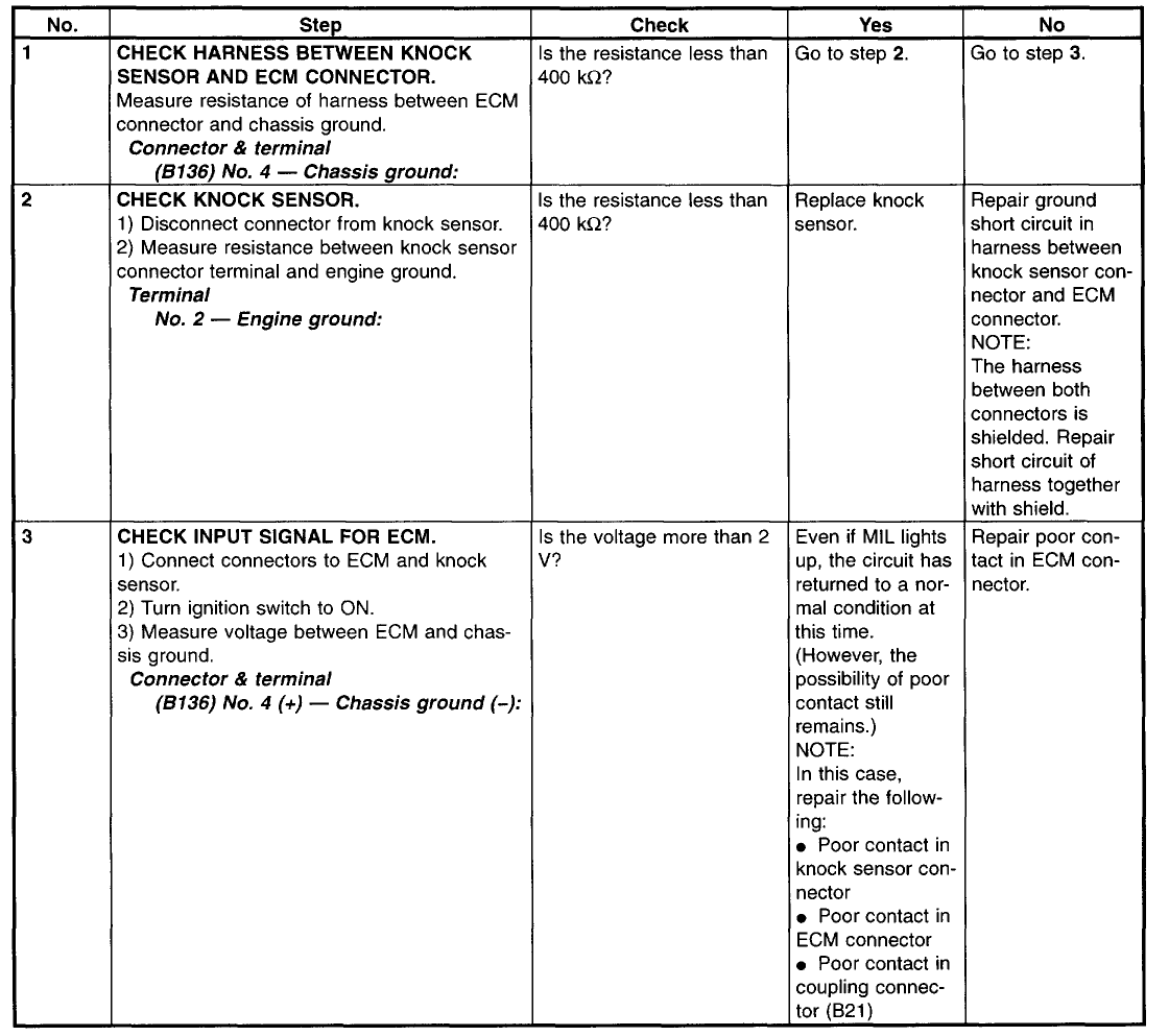

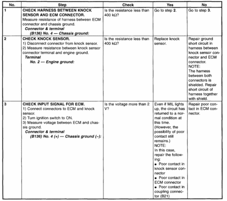

I found the attached diagnostic instruction for my car. Going to try it now.
Wed, 29 Aug 2007 06:39:00 +0000
Well, it's hard to tell. The resistance kept jumping around. Didn't know measuring resistance could be this hard!

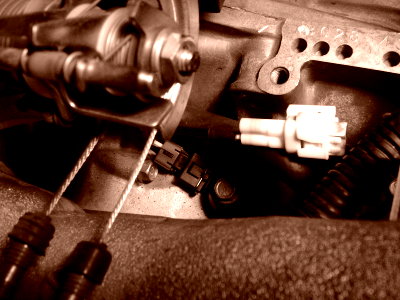

I got the sensor last week and replaced it in the car. So far, the trouble code hasn't came back. The following photo shows the knock sensor screwed into the engine block under the throttle body cables.

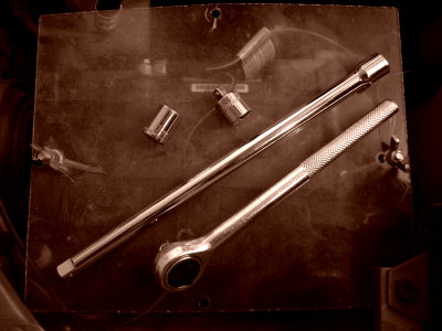

I used the following tools to remove and replace the knock sensor: 1) Rachet; 2) Extender; 3) Socket Adapter; 4) 12mm Socket.

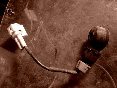

This is a photo of the knock sensor. It's the used one. The new one is exactly the same, but looks better. I should have shot a photo of the new one instead. But I've already installed it before shooting the photos.
