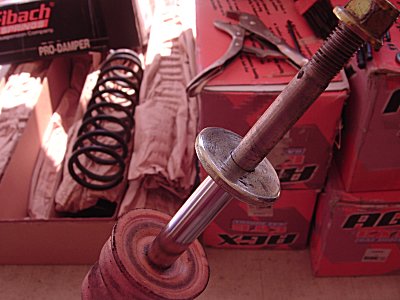

I found out it is because I didn't install this super heavy duty washer that was on the old shocks (see photo below). I didn't realize this super heavy duty washer was removable. When I tried to remove it with my hand, it wouldn't budge. But after I hit it with a vise-grip, it came off pretty easily.
So I ended up removing the Eibach Pro-System from the Civic again. Took everything apart and installed these super heavy duty washers. Now the car drives fine.
