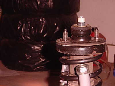

Neither Lowes nor Home Depot had l0mm-l.25 nylon lock nuts. l ended up buying a regular 10mm-1.25 metal hex nut and a 3/8" nylon hex nut. I think I will torque down the metal nut. Then screw on the nylon nut to act as a lock nut. Think it'll work?
Sat, 29 Aug 2009 04:30:54 +0000
Ok, I've done it. Here is a photo showing the 10mm-1.25 metal hex nut and the 3/8" nylon hex nut installed on top of the strut.
