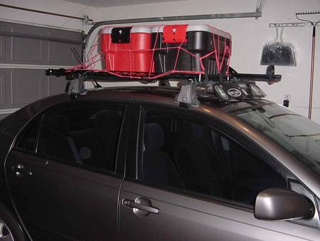

Here's a quick picture I took tonight after temporarily putting my Container Store basket case onto my yakima roof rack.
I just used 4 zip ties to test it out and try the Bell Cargo net I got at Wal-Mart for $9.99 - that includes a cargo bag.
I am planning to use very large/strong black zip ties from Home Depot to attach the basket (shelf) to the round bars on my yakima roof rack. The red cargo net goes good with it though I'll need to be sure the net hooks are secure onto the basket as I don't know if it will always be that full.
I also use the Rubbermaid "Action Packer" plastic storage containers (in picture!!) from either Target, Home Depot or Lowe's to pack gear in when I am travelling. And I was glad to find that the smaller one's are a perfect fit for the basket.
Hope that helps and gives you an idea of what I did!

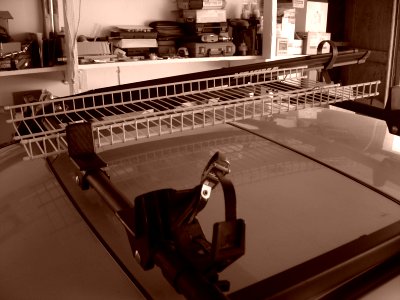

Several weeks ago, I need to put our baby travel crib on top of the Yakima rack. But the baby crib was too short. So I went to Home Depot to pick a pair of stacking shelfs (18"Hx36"Wx12"D"). It was the perfect size. I strapped just one of the shelves on top of the Yakima rack with zip ties and the metal ties that you can find at supermarkets. The result is shown in the photo below.
You'll definitely want to use zip ties. A few days later, I found that one of the metal ties has been unfastened. I suspect someone tried to take the shelf until they got to the zip tie, realizing that they don't have a wire cutter with them and gaved up.
