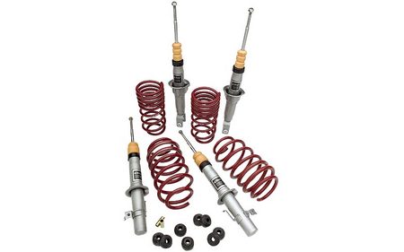

I happen to find a photo on Eibach's web site showing the Pro-System (photo is attached below). The suspension in the photo looks exactly like the suspension for the 1995 Honda Civic EX, short of the silver paint (black paint on the ones I have). The damper struts with the fork on the bottom are the rear struts. In the photo, E72-X003A01 is installed on the front strut, while E72-007A01 is installed on the rear strut. Can I trust this photo?
The photo also seems to have installed the bumpstops upside down. At least that's what it seems like compared to the stock bumpstop on the stock strut. Eibach installation instructions also seems to indicate to install the bumpstop upside-down from the photo.
