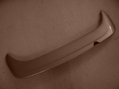

Although the wing was damaged, with no chance for salvation, the third brake light was still in good shape. A small plastic piece broke off the light, but it can be easily glued later.

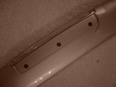

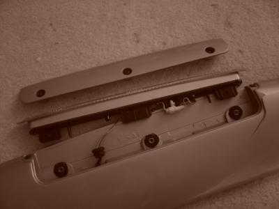

The third brake light is covered by a silver plastic on the bottom of the spoiler. The cover is secured with three screws. Unscrew the three philips screws and you can remove the cover and the brake light easily.

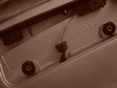

The brake light electrical cable is routed through the wing into the trunk. Slowly work the rubber bushing surrounding the cable loose. Pull the cable through the wing.

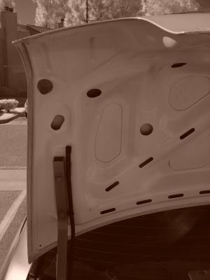

Having thought through my game plan, and the third brake light is in good shape, I scouted the car for the premium location in the car. The rear deck seems to be the best location. Looking in the trunk, I found there are already holes in the chassis for me to drill through the deck easily. I'll have to drill two holes, one to secure the third brake light and the other for the wiring.

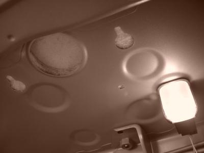

After drilling the holes, I mounted the third brake light on the rear deck with some fastening bolts and wing screws. Then I routed the electrical cable through the rear deck into the trunk.

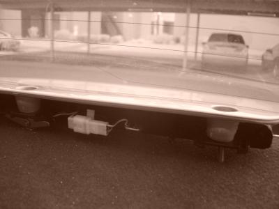

I had to patch additional stereo wiring cables to the end of the electrical cable, because the one on the brake light isn't long enough. Wiring had to reach the connector on the trunk. Some spicing and cramping was easy with a cramping tool from the local home improvement store.

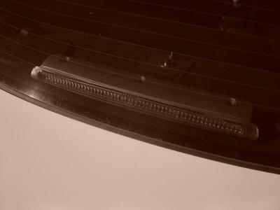

After patching in all the cable, the brake lighted up as expected. Installing the third brake light was quite easy. It was a cheap and effective solution to get my car back on the road, before I get the back end fixed.
