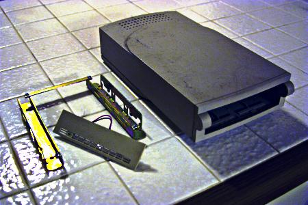

The candidate I picked for this project is the SCSI case (see picture below) for the NEC MultiSpin 6Xp CDR-602 external CD-ROM drive. I have used this case previously with my SCSI hard drives. It looks slick and is very robust. Even though I am using a SCSI case, which is harder to find today, you can use any hard drive enclosure that you may already have. There are a lot of USB enclosures out there on the market now. You can convert an USB enclosure into a SATA case with the same instructions here.
In the picture below, you can also see a 5-1/4" to 3-1/2" hard drive bracket. Back in the days, the drives were 5-1/4" wide, so this enclosure was made to accommodate the bigger drive. A bracket is needed to mount the smaller 3-1/2" SATA hard disk. The face-plate in the picture is slightly modified. I had cut it smaller in previous projects to fit this case. The face of the NEC MultiSpin 6Xp has a smaller footprint than a standard 5-1/4" drive.

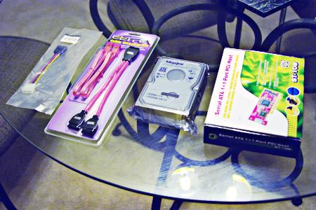

To complete this project, I needed a few things. I already have the 300 GB Maxtor SATA hard drive, because that's the mistake that got me here. A SATA power cable adapter and a SATA data cable is needed for the enclosure. I also bought a Serial ATA 1+1 Port Host Controller ST-108, because I don't have a motherboard that support SATA drives. This PCI controller board has both internal and external connectors and is perfect for this application.

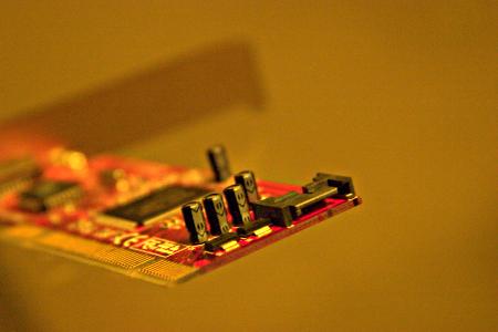

The nice thing about the SATA connector interface is that both the internal connector and the external connector are exactly the same. This design is so different from the previous storage interface designs that I have seen. For example, the SCSI internal connector is a 50-pin ribbon cable, while the external connector is a 50-pin centronic connector. Whoever came up with the same connectors for SATA is a genius! I don't know why I haven't thought up that design myself.
The following picture is a picture of the internal connector.

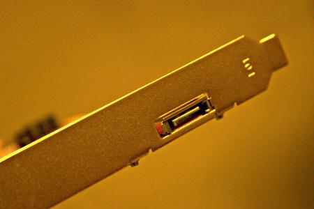

Here is a picture of the external connector. See, they are exactly the same!

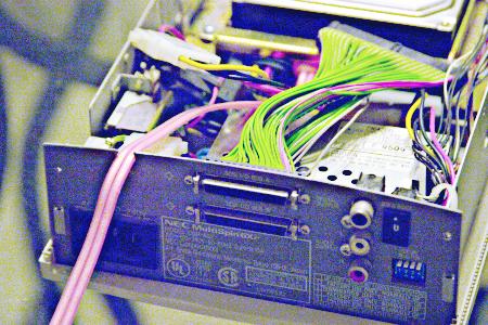

After having all the parts on hand, it's time to get started. I used a wet paper towel to wipe off the dust that has gathered on the enclosure over the years and took it apart. The NEC case is particularly easy to take apart. There are two Phillips screws at the back of the case. Remove the screws and release the four tabs toward the bottom front and lift the cover away. The case you have is most likely different, but just as easy to take apart.

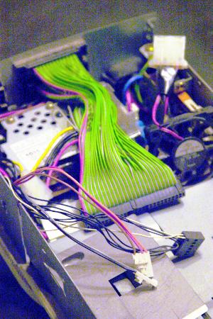

After removing the cover, the wires are revealed as shown in the picture below. There are many more wires in this SCSI case than what you'll see in today's USB cases. This case was made for a CD-ROM drive, so it included several audio cables. Plus, external SCSI devices have ID selection switches in the back that needed an additional cable to the internal drive.
In this project, we will be ignoring most of the existing cables in the case. The hard disk will only take advantage of the power cable.

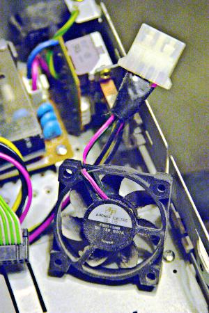

The fan in the picture below is a special hack I placed into the enclosure years ago. It came off an old CPU and helps ventilate the interior.

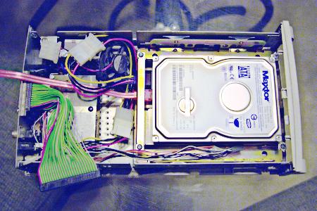

Once I cleaned out the enclosure, I started getting the hard drive ready. See the hard drive I got is a 3.5" drive and I had to convert it into a 5.25" drive using the mount bracket. Just two screws on each side of the drive is necessary to attach the mount. Next, I attached the SATA power adapter to the power cable in the enclosure. I noticed that the mounting bracket would get in the way of the data and power SATA cables after installing the drive into the case. So I attached the two cables to the back of the drive before mounting the drive into the case. Finally, I lowered the drive into the enclosure and screwed it in with two screws on each side (see picture below). Note that the SATA data cable is sticking out at the end of the enclosure.

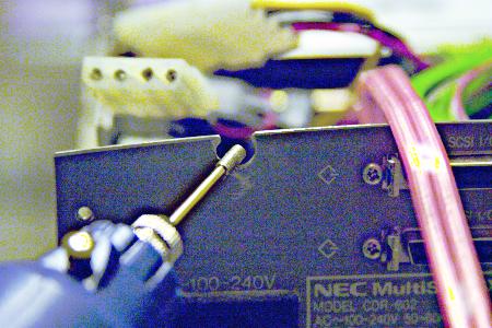

With the pilot hole in place, start moving up in drill sizes and gradually increase the hole in the metal sheet. I ended up with a 21/64" drill bit. Finally, smooth out the hole with a Dremel high-speed rotary tool (see picture below).
Tue, 8 Nov 2005 00:32:41 -0800
Make sure you use the metal sanding bit. Don't use the stone one. I made the mistake because I hardly ever use my Dremel tools (read as lack of experience). If you make the same mistake as me, you will have a stone-sanding bit with a notch in it, like the one in the picture below.

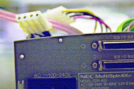

After smoothing out the hole, route the SATA data cable through the back of the case as shown in the picture below.

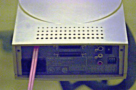

Picture below shows the final product. It's pretty clean. This SATA case only needs a single data cable and a standard PC power cable. The catch is that the SATA data cable is always attached, so that there is always a tail sticking out. The SCSI connectors in the back and the SCSI cables in the case are still functional and the case can be returned to a SCSI case at anytime.

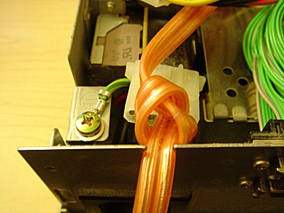

Thanks for the strain relief suggestion. I opened up the case again and tied the data cable into a knot where it exited the case to provide strain relief (see picture below).
Wed, 16 Nov 2005 23:52:32 -0800
Don't Use a Knot as Strain Relief!
Last night, I connected the drive to the computer to do my weekly remote back up. After booting the computer, the SATA drive did not show up in Windows Explorer, nor in Hardware Manager. I turned off the computer and the drive to try again. Same problem persisted. I opened up the case and made sure all of the cables are attached and the drive spins up. Same problem persisted.
Finally, I untied the strain relief nut and turned everything back on. Lo and behold, the computer recognized the drive. I had not used the drive since the day I tied the SATA data cable into a knot. I suspect that the radio interface generated when the SATA data cable is in a knot scrambled the SATA data signal. Conclusion, don't tie your SATA data cable into a knot for strain relief.
