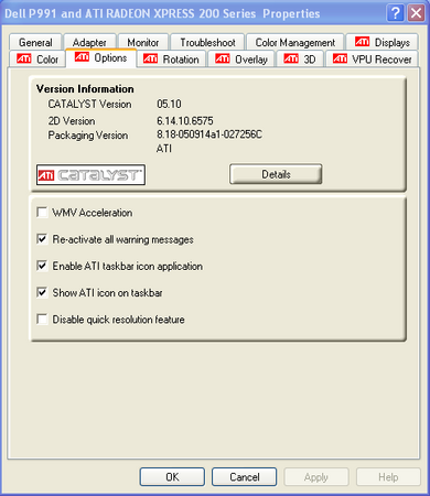

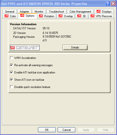

The first thing I wondered about is whether ECS EliteGroup supplied the latest ATi graphics display driver with the motherboard. I noticed that CATALYST 5.1 is installed on my system.

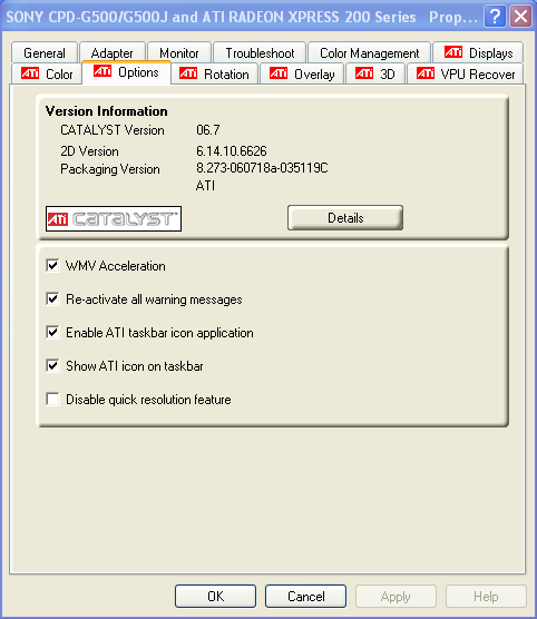

I went onto ATi's web site and quickly found that the latest version of the ATi Radeon display driver for Windows XP is version 6.7. I downloaded the driver and installed it. Now Battlefield 2 works just fine and it no longer crashes.
I'm sure the latest graphics driver will benefit my other games as well.

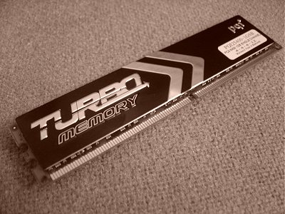

Finally, I traced it down to one of the two memory stick modules that I installed in the system. I had bought 2 PQI 1GB PC2-5400 Single Channel DDR2 memory modules. One of them work just fine. The other one crashes constantly.
Time for a replacement. Too bad I blamed it on the ATi graphics card.
