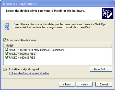

I opened up Device Manager and looked at the graphic driver. Device manager reported "RADEON 9600 PRO Family (Microsoft Corporation)". It looks right. But what's this "Microsoft Corporation" about? And my card is a regular 9600, not a PRO. That's when it occurred to me that I had re-installed Windows and not the ATi Radeon graphics driver.
So I did. I downloaded the driver from ATi. Now Device Master reports the driver as "RADEON 9600 SERIES". NWN also runs extremely fast and smooth now, even when the graphics setting is set to the highest. I guess there is a difference between drivers supplied by the manufacturer and driver supplied by Microsoft Windows XP.
