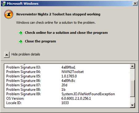

When I loaded up the NWN2 Toolset, I got the "Neverwinter Nights 2 Toolset has stopped working" error message (see screen shot below). Looking at the problem details, I noticed that it crashed on "System.IO.FileNotFoundException". That's weird.
However, I remember when I installed the game, it had an error message at the end of installation. Yet, the game still worked. Searching around a bit, I found this useful thread: Problem with the Toolset and Vista 32bit .... It recommended that I re-install DirectX from the DVD; just run "DXSETUP.exe" in the "DirectX" directory on the DVD.
After installing the DirectX drivers, NWN2 Toolset loaded without any problems. Now I'm off to build the NWN2 Matrix Loading Module.

it stopped working again
Description:
Stopped working
Problem signature:
Problem Event Name: CLR20r3
Problem Signature 01: nwn2toolsetlauncher.exe
Problem Signature 02: 0.0.0.0
Problem Signature 03: 452a93b4
Problem Signature 04: NWN2ToolsetLauncher
Problem Signature 05: 1.0.2473.18714
Problem Signature 06: 452a93b4
Problem Signature 07: 5d
Problem Signature 08: b
Problem Signature 09: System.IO.FileNotFoundException
OS Version: 6.0.6002.2.2.0.256.6
Locale ID: 1033
thats what it comes up with.

Didn't work for me, I had the same problem. Rather than say it stopped working it just crashes.

WOA, it had huge lag but it suddenly just opened up. Thanks a bunch.

Thank you, I am really looking forward to using the toolset now that it works!

i need help because i don't kno where to find dxsetup can anyone help?

In the original post:
Thu, 19 Aug 2010 15:50:53 +0000
I have done the above but I am using an Asus G60JX with a GeForce GTS 360M 64 bit, Win 7, I have been unable to open the tool set for NWN2. Can anyone please help me??????????

Try running with xp compatibility with visuals off, when it starts do (ctrl,shift,esc) and change number of cores to one.
If none of that helps just another reason why Nvidia sucks ha ha ha ha ha

awesome thnx! now I can finally use the toolset

Thanks a lot this made my toolset work, i hope it can improve my framrate aswell.
