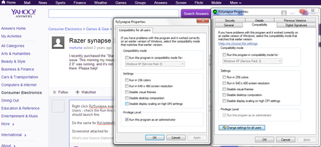

Seems Synapse has gone rogue and changed its security settings - you need to run the app as administrator.
Go to your Razer install file - on Win7 64-bit, mine is located under C:\Program Files (x86)\Razer\Synapse.
Right click RzSynapse.exe and open properties, go to Compatibility tab, and Change Settings for All Users - check the Run this program as administrator checkbox, OK/apply/whatever you need to do. App should launch fine.
Do the same for RzUpdateManager.exe.
Screenshot attached for clarity's sake.
