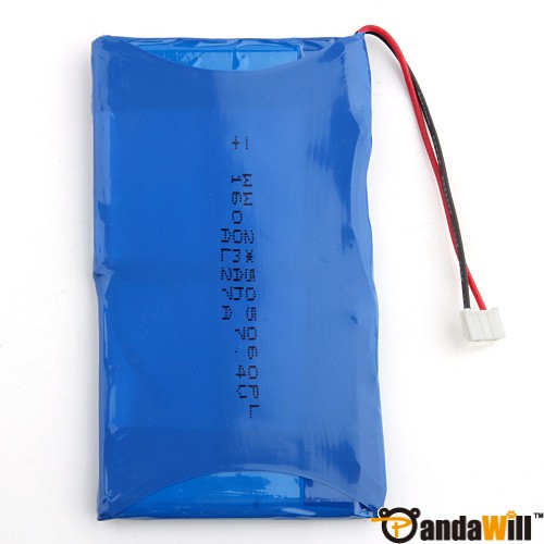

Looking for way to hook up alternative batteries, we needed to know the battery spec of the thing. After searching around, we found that PandaWill used to sell (out of stock) replacement batterise for the Eken M-001. It had a photo of the battery with specs printed on it (see photo below):
WW 2*505060PL
1600mAh 7.4V
AL27A
The battery in our Eken M-001 looks exactly the same without the spec labeling. It's looking like we can use a 7.4v airsoft battery to power this tablet.
