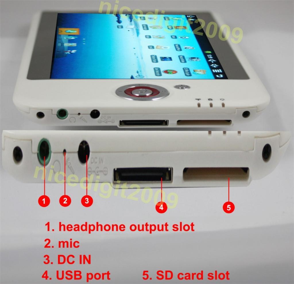

The only obstacle is how to hook it up to the electric system of your car. Before we dive any further, let me show you the device we are talking about. The attached image shows the gadget and its ports.

So far, I see a DC In port and an USB port. I'm assuming that because there are two different ports, you can't charge this device via USB. (Please correct me if this is inaccurate.) Thus, you can't just buy a cigarette to USB DC adapter for charging this device, which, I think, it's the best way to go.
Another option is to use a 12volt DC/AC converter with the AC adapter of the device. This is probably the most inefficient method and requires lots of space in your car. Plus, I don't know how long your car battery will last with the engine off, while you are using the device. This is the last resort and we want to refrain from this method at all cost.
Unfortunately, the specification for this device doesn't now how the DC voltage used by the DC In port. So we don't know if we can tie it directly to the 12volt DC car battery. Does anyone have the spec for the AC adapter?

According to a post in this thread:
http://groups.google.com/group/ekenm001/browse_thread/thread . . .
9v, 1.5amps, 4x1.7mm dc plug
gnowk
Fri, 14 May 2010 15:13:59 +0000
Thanks. That's going to make tying it to the car a bit harder. But I think my co-worker know how to wire up something with a small heat-sink that could do it.
Fri, 14 May 2010 21:50:53 +0000
Ok. I got the tablet and verified that the above power spec is true. The back of the tablet says "Model No.: M-001". The power spec shows 9V. The small power adapter supplies up to 1500 mA of current and has the following model number: SY15W01-9V.
The tablet can only be charged via this adapter. It does not charge via the USB port, unfortunately.
