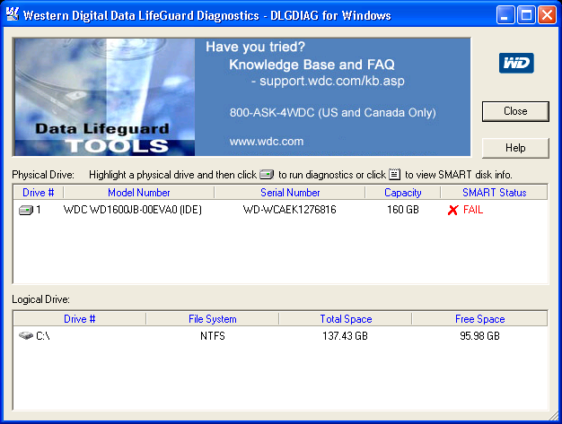

Today, I downloaded the Western Digital Data LifeGuard Diagnostics utilities for Windows. This tool is available on Western Digital's web site free of charge. I wanted to see exactly what's causing the S.M.A.R.T. message and what I could do about it.
After installing the software tool, I ran the diagnostics and immediately see a SMART Status - FAIL (see picture below).
Tue, 20 Dec 2005 23:34:28 -0800

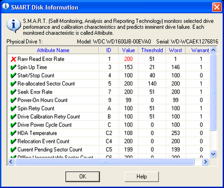

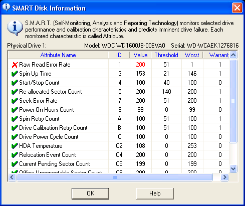

Double-clicking on the Fail message brought up the SMART Disk Information (see picture below). From this page, it appears that the drive's raw read error rate is extremely high. Everything else seems to be working just fine.
But I don't know how to read these attributes, because the next attribute seems to have exceeded the threshold as well, though the status screen indicated that it is ok.
Tue, 20 Dec 2005 23:39:32 -0800
After reading the "Crash Prevention" article (see Related Links below), I have determined how to read this information table. The following paragraph is an excerpt from the argicle:
"The VALUE column has the current value, WORST has the worst measured value so far, and THRESH the factory threshold value. A current value equal to, or below, the threshold value indicates an error condition for the attribute in question."
Wed, 21 Dec 2005 13:10:48 -0800
