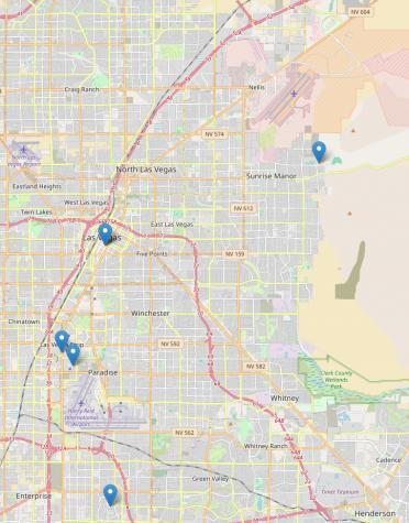

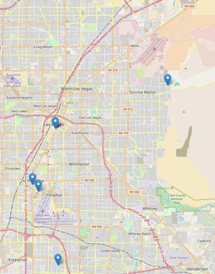

My girlfriend and I are going to EDC LV 2025. We are each taking a Meshtastic radio with us. So we can text each other and track each other even without carrier service.
Currently, I see five Meshtastic nodes around the Las Vegas area. None at the Las Vegas Motor Speedway.
What would it take to get our nodes on the MeshMap? Is anyone else down to light up EDC on the MeshMap?

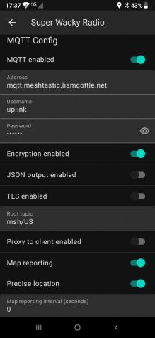

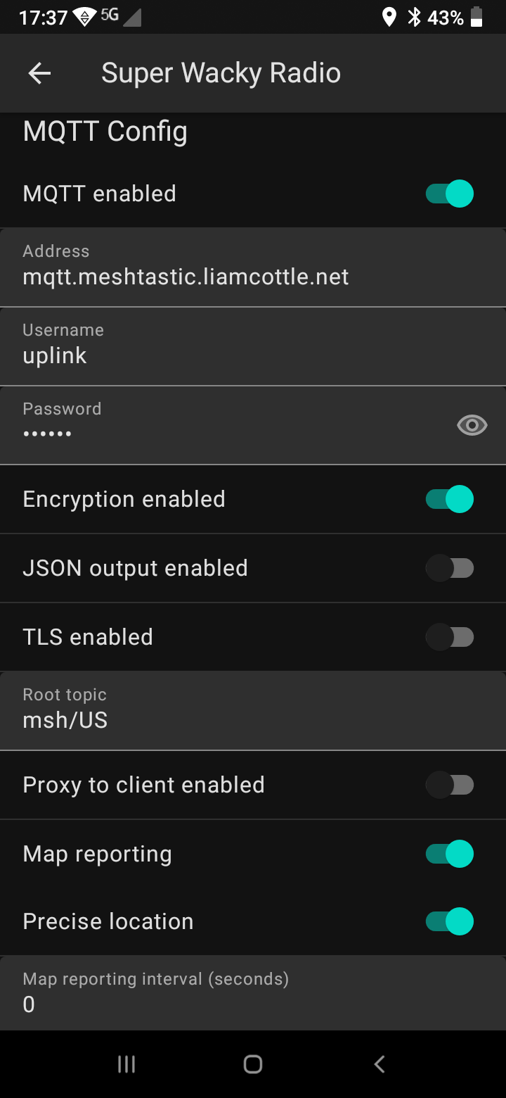

Yes! I want to light up the MeshMap. Unfortunately, the MeshMap is currently down. And with EDC only 1.5 weeks away, I suggest we light up Liam Cottle's Meshtastic Map.
The configuration to get on that map is as follows in the attached "MQTT Config" screen shot. Password is "uplink". Enable "Proxy to client enabled" when you are ready for the world to see where you are at. Make sure to scroll down the screen to tap the "Send" button to apply your setting to your Meshtastic radio.

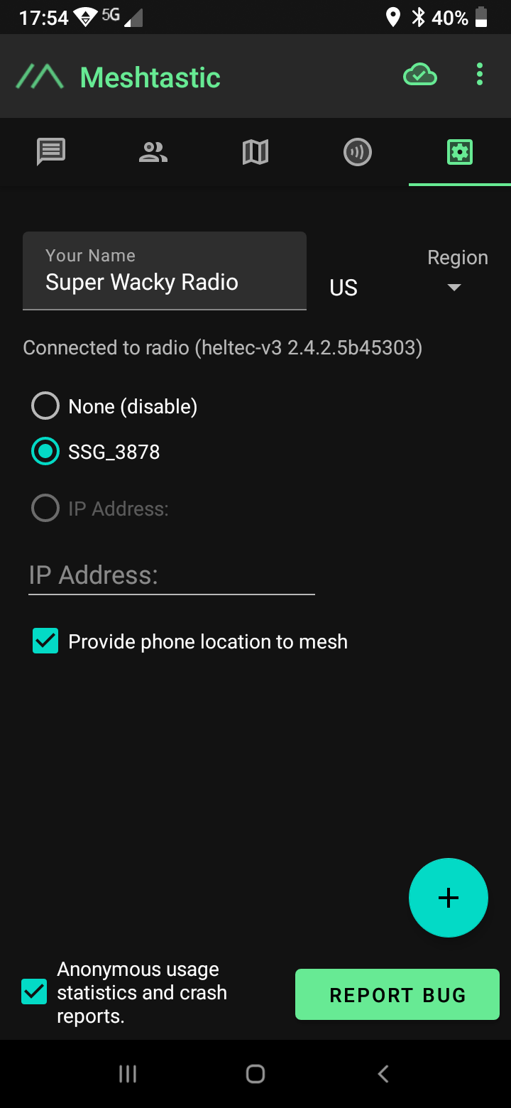

Oh, yah, don't forget to enable "Provide phone location to mesh" as shown in the screen shot below.
