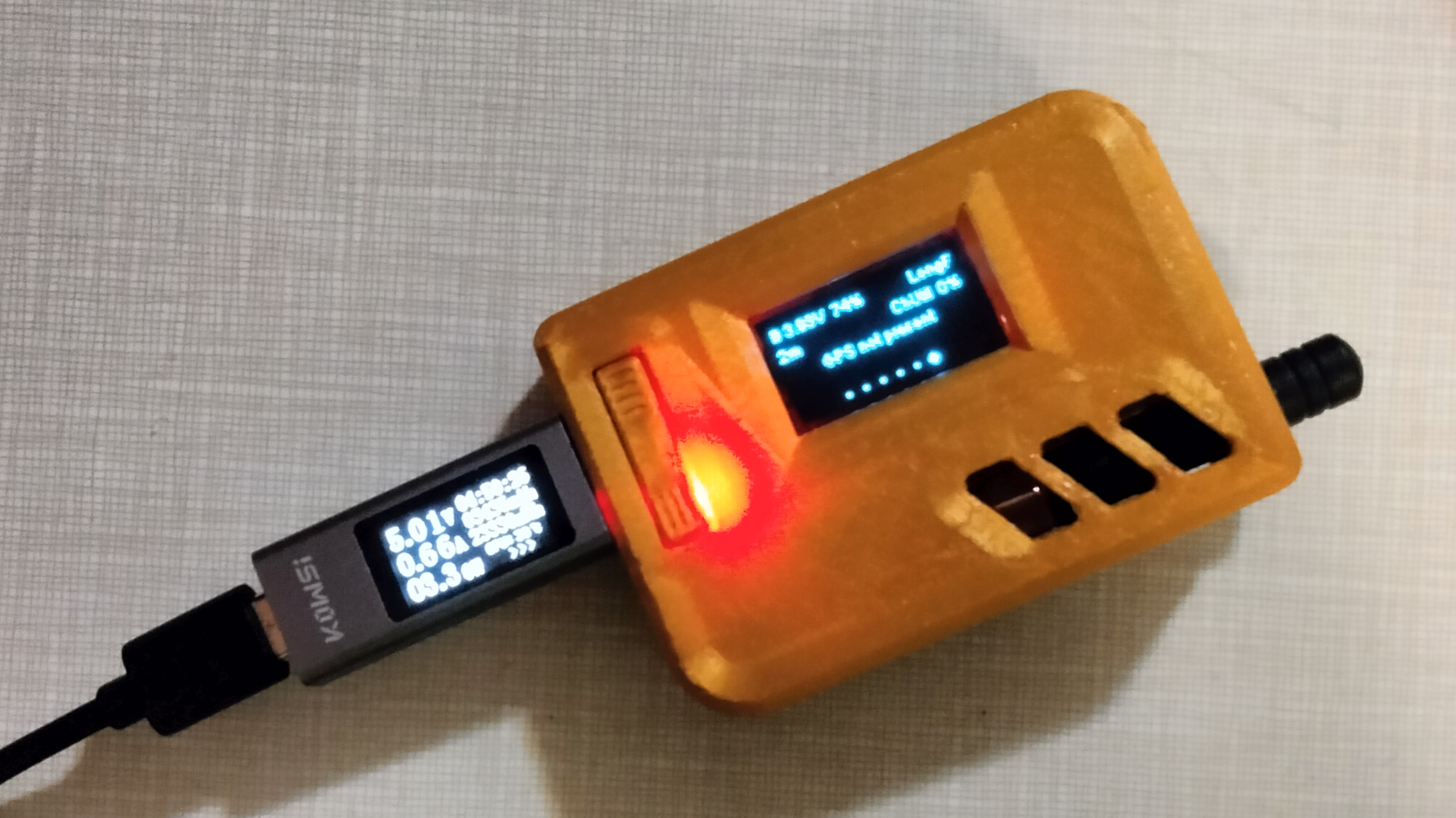

Just successfully put together my Meshtastic client using Heltec V3 with 1200 mAh. Fits perfectly in the CyberNet Case for Heltec V3 and 1200 mAh Battery - LoRa Meshtastic Radio Device by EveryThang3D. Attached below is the power consumption as measured with diymore USB C Power Meter.
Picture a bit hard to read. It basically show 5v 0.66 amp current draw, which translates to 3.3 watts.
