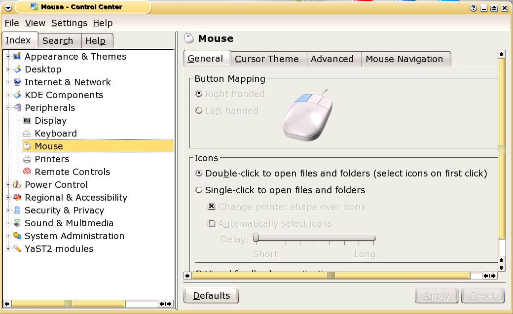

I use KDE on SUSE everyday. The first thing to do is to remap the mouse buttons for left hand use. I still want to use my index finger on the "left" mouse button. I found the "Mouse" module in "Control Center" > "Peripherals".
"Button Mapping" is the first set of options in that module. However, it is grayed out! I can't change it! But at least I finally found where to change "Single-click to open files and folders" to "Double-click to open files and folders". Now the Konqueror file browser would work more like Windows Explorer.
