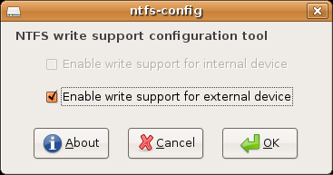

So I plugged my NTFS USB drive into my Ubuntu 7.04 laptop. The drive showed up in Ubuntu right away. And I was able to access the drive without any problem. But when I tried to write to the drive, Ubuntu reported that the volume is a read-only system.
I understand that the latest stable Linux NTFS write drivers is the NTFS-3G drive. And there is a simple GUI-based configuration tool. I searched for NTFS-3G in the Synaptic Package Manager and found both ntfs-3g and ntfs-config. You can install the driver by typing the following on the command-line:
sudo apt-get install ntfs-config
After installing the Linux NTFS driver, I plugged in my external NTFS drive again. But the same problem persisted. It turns out that the NTFS-3G driver disable the write capability on external drives by default. To enable the write capability, run the configuration tool by typing the following command:
gksu ntfs-config
Then check the "Enable write support for external device" option as shown in the screen shot below. After that you will be able to write to your NTFS drives.
