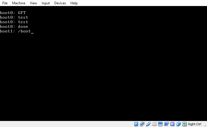

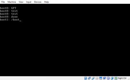

Anyway, it stopped booting with following output (see screen shot):
boot0: GPT
boot0: test
boot0: test
boot0: done
boot1: /boot
It just gets stuck or hangs there. Not sure exactly what causes this problem.

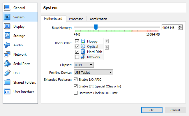

I played around with the settings in VirtualBox for a while. And I did manage to get it to boot some times. I had to check the "Enable EFI (special OSes only)" checkbox (see screen shot below).
Originally this checkbox should not be enabled (see my other threads on installing the Hackintosh). But now it does. And the virtual machine only boots up fully every other time.

Even though I did get the Hackintosh to work with VirtualBox 5 by enabling the EFI, it has difficult booting, failing every other time. And when it did succeed in booting, it crashes on shutdown. Also, it only boots to 1024x768. The full resolution no longer works.
I just installed VirtualBox 5.1.12, which was released two days ago. But the problem persists. Looking to downgrade VirtualBox to get my Hackintosh to work again.
Fri, 23 Dec 2016 08:16:57 +0300
OK. I just downgraded VirtualBox to version 5.0.30 and the Hackintosh works again. So it's not version 5 that is the issue, it's version 5.1 that causes it to fail. Not sure why at this point. But at least I can continue to use the Hackintosh with VirtualBox 5.0.30.
