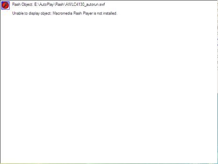

I've got a nice AirLink101 AWLC4130 wireless G adapter at Fry's on sale. It'd help me replace my slow and outdated wireless B adapter. But after inserting the installation disc, the installation program popped up and showed the following error message:
Flash Object: E:\AutoPlay\Flash\AWLC4130_autorun.swf
Unable to display object: Macromedia Flash Player is not installed.
Ironically, I can't install the Adobe Flash Player without getting on the Internet. And I can't get on the Internet if I can't install the driver for the network card. Who ever wrote the installing software didn't quite think things through.
Fortunately, you can run the driver and utility setup software directly on the disc's Utility directory. Just open up the disc content, enter the Utility directory, and double-click Setup.exe. After installing the software, reboot the computer, insert the Cardbus network adapter, and away you go.
