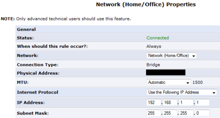

Got to 'My Network' and click 'Network Connections' in the menu on the left.
Click the 'edit' button of 'Network (Home/Office)'.
Hit the 'Settings' button on the bottom.
Voila! All the settings that real routers have right in their front page cunningly hidden!

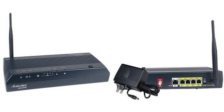

What version is your firmware? What does your router look like? Mine is all black and boxy, like the attached image.
Mon, 26 Apr 2010 00:15:05 +0000
Hi Chieh,
Sorry for the late reply.. I have the same mdoel number as your router but it's different 9attatched is image)
i'm not sure how to find out the firmware...

Ok. Looks like Verizon updated the firmware on my Actiontec MI424WR FiOS router just fifteen minutes ago. It knocked me completely off line. I couldn't see my router at all. Then I realized that it completely reset with the default 196.168.1.1 IP address. It delete all my settings. And now I'm pulling my hair out trying to set everything back to normal. The configuration file is now encrypted. But I managed to find a different way to change the LAN IP of the router. Here is the steps:
  1. Log in to the router.
  2. At the main screen, click the globe icon next to "Broadband Connection" in the left-most column.
  3. Click on the "Network (Home/Office)" heading in the first column of the table.
  4. Click on the "Settings" button on the bottom of the screen.
  5. Change the IP address to whatever you want.
  6. The IP address should not be in the range of the "IP Address Distribution" defined on that same page. So you should change the range. In my case, I disabled DHCP completely.
  7. Click the "Apply" button on the bottom of the page.
