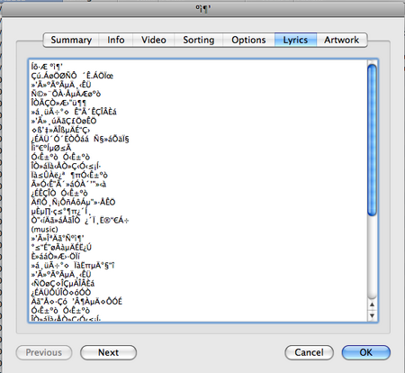

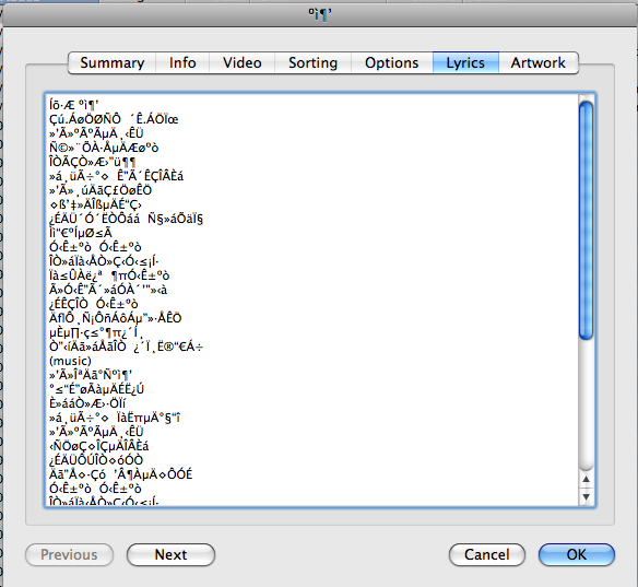

also, how do i get itunes to properly recgonize the singer and lyrics?

the meta info is in GB encoding (simplified chinese non unicode), iTunes need unicode. i wrote a crappy script to convert some of the info (artist, album, title, but not lyrics). it might be buggy, so make a backup before conversion.
http://github.com/gnowk/mp3_tag_hanconvert
you need additional modules, just look at the top of the script.
this might work too, but i haven't tried it yet.
http://code.google.com/p/mp3-tag-iconv/

the latest version handles lyrics and comments conversion properly now.
