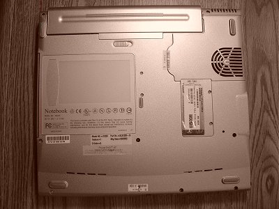

The Averatec 3120V is a sub-compact notebook, which means Averatec packed a lot of functionality into a very small space. Therefore, there is special access door to simply pop out the hard drive. However, Averatec did make the process quite simple by hiding the hard drive under the touchpad. To get to it, you have to remove the seven screws on the bottom of the notebook, toward the front (see photo below).

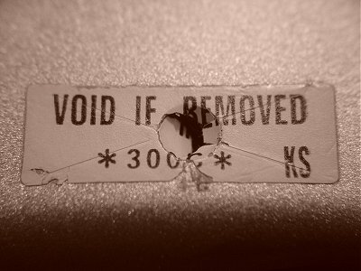

One of the screws is under the "VOID IF REMOVED" sticker (see photo below). By now, the warranty on my Averatec 3120V is long expired, so I didn't have a problem breaking the seal. I left the sticker on the notebook just for fun.

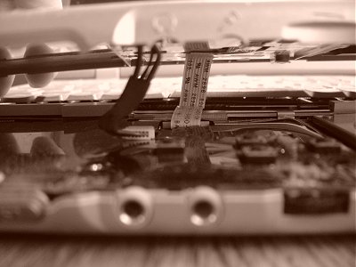

After lifting the lid, carefully lift the touchpad. Don't tug and pull on it. There are two wires running from the touch pad to the notebook (see photo below). Don't break those cables.

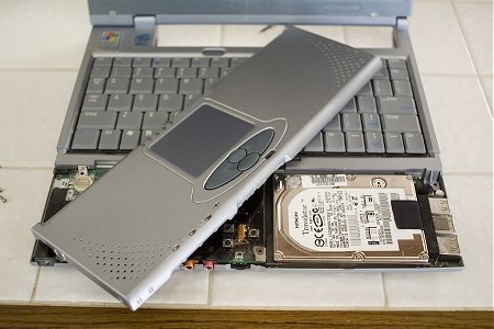

Don't bother disconnecting those cables. You can get to the hard drive simply by rotating the touchpad 45 degrees as shown in the photo below.
Tug on the black fabric next to the three USB ports and you can remove the hard drive for replacement.
After that, all you have to do is remove the hard drive from the bracket, put another drive into it, and stick it back into the notebook. Assembling the notebook is simply reverse of disassembling it.
