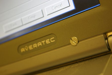

At home, I used a 3/32" drill bit to make the existing screw hole bigger. In addition, I drilled through the LCD panel. I did peak into the panel to make sure that there are no wires and circuit boards in the way. In the end, I was able to slide the #4-40 screw through the hole, shown in the picture below.

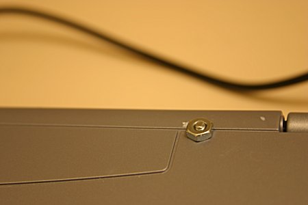

The bolt pertudes from the other side of the plastic. A #4-40 nut is used to fasten the screw (see picture below). I used a screwdriver and a set of pliers to tighten the nut. The LCD seems very sturdy now. And if the screw and nut is ever to loosen, I can always re-tighten it with household tools. And if the screw or nut gets lost? Well . . . Home Depot and Lowes has tons of these nut and screws.
