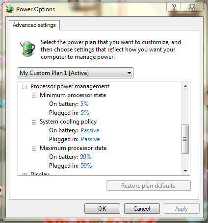

It seems that many DV6 users are experiencing the overheating problem. Some users are suggesting limiting the maximum processing power to 99%, rather 100%. In addition, they suggest changing cooling policy to "Passive", rather than "Active". Their suggestions seem to make a lot of sense.
You can change these advance settings in "Control Panel" -> "Hardware and Sound" -> "Power Options" -> "Change plan settings" -> "Change advanced power settings" -> "Processor power management". See screen shot below.
Hovering over the system cooling policy setting, I noticed that "Active" says, "Increase fan speed before slowing the processor". After changing to "Passive", it says, "Slow the processor before increasing fan speed". That's a sensible way to go, because the CPU may be overheating and increased fan speed may not help enough.
I also changed the maximum processor state to 99%. I have been monitoring the system after these changes. I will report how the computer performs with these changes.
