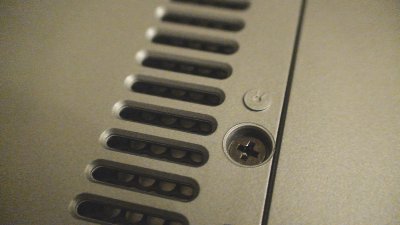

The CD/DVD drive on the HP dv1227us notebook computer is extremely easy to remove. Simply unscrew the screw marked with the slotted donut as shown in the picture below. Then pull the drive out. It's that easy.

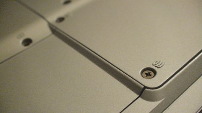

The hard drive is located under the panel on the bottom right hand side of the notebook (when viewed from the bottom). To remove it, first remove the two screws that are marked with the triple disc symbols (see photo below).

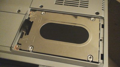

After removing the panel covering the hard drive, pull the black tab upward (see photo below). The hard drive will be removed with the metal bracet.

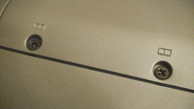

The dv1227us notebook has two memory slots. By default, they are taken up by two 256 MB, PC2700, 333 MHz, DDR memory modules. You can upgrade them with larger memory modules. To gain access to the memory bay, find two screws with the memory chip symbol next to them (see photo below). Remove the two screws and lift up the panel.

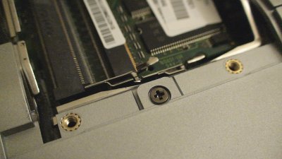

Nevertheless, With the memory bay panel off, there is a screw located next to the memory modules (see photo below). Remove this screw and the mini-PCI bay panel can be lifted up easily.
