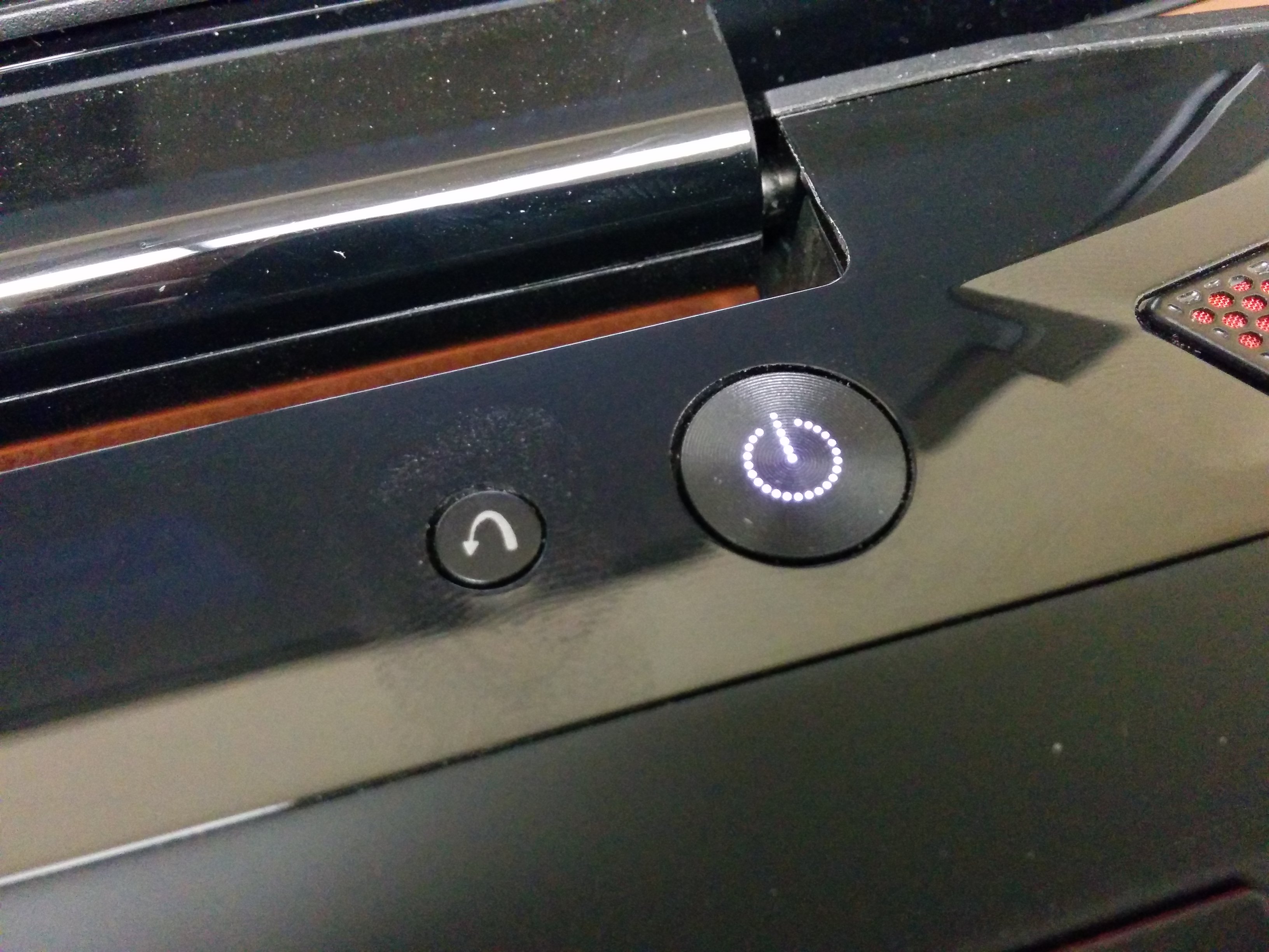

Just recently gotten a Lenovo Y50 gaming laptop. And apparently virtualization is turned off in the BIOS. It is unclear why it is turned off. But I had to turn it on. On many laptops, you pressed the F2 or F10 key to enter the BIOS on start up. Those keys didn't work on the Lenovo Y50. Luckily, the Lenovo Y50 instructions stated clearly:
"Novo button - When the computer is off or in hibernation mode, press this button to start the Lenovo OneKey Recovert System or the BIOS setup utility, or to enter the boot menu."
Where is the Novo button? It is the small button next to the power button. See photo below.

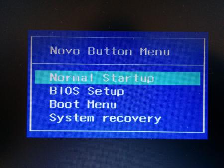

Following photo shows the Novo Button Menu, which includes:
- Normal Startup
- BIOS Setup
- Boot Menu
- System recovery
