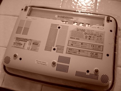

First thing I did when I got my MSi Wind was to take it apart. you see, I had hoped for a dedicated drive bay cover so that I could get to the drive easily. But MSi did not provide that capability as you can see from the photo below. So to get to the drive I had to take it apart.
Thu, 30 Oct 2008 03:58:28 +0000
There are nine screws that you have to remove. One of them is covered by the "Warranty Sticker Void if tampered". Even though they claim that you are only voiding the sticker, they probably mean you are voiding the warranty of your netbook.
Nevertheless, you have to get in there if you need to add more RAM, swap hard drive, or change network adapter. So once you have unscrewed the case, you can remove the back panel.

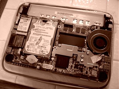

The photo below shoos the inside of the netbook. The miniPCIe network card is on the for left, next to the hard drive. The empty memory slot, toward the center, is ready for another gig of RAM.

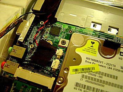

To remove the hard drive, you have to remove the wireless N network card first, because there is a screw underneath. Once you remove the network card the screw becomes apparent (see photo below). Keep in mind that the 802.11n network cardis also secured by a screw under its antenna cables.

Just before I decided to yank out my hdd I knew I had to look online for a clue why this hdd appeared to be lodged to the mainboard. Your tip about removing the wireless nic first (where that naughty screw was hiding) saved the day! I decided to replace that ole 160 Gb heat dissipater for a smooth OCZ Vertex 2 60 Gb SSD disk. It was definitely worth the investment, it now runs even better (duh!) and I have extended the use of this fine netbook with another three years or so assuming the other components will last that long.
