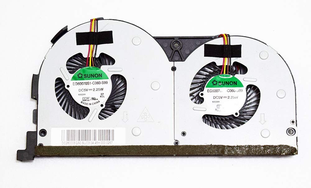

I found a "New CPU Cooling Fan For Lenovo Y50 Y50-70 Y50-70AM Y50-70AS Y50-80 DC28000EQF0 AT14R0010M0 series Laptop" for $9 shipped on Amazon Prime. Pretty good deal. It's going to arrive 2 days from now. Will post instructions on replacing the fan then.
The following are the specs based off the Amazon product photo (see attached below).
Sunon
EG60070S1-C060-S99
DC5V 2.25W
K4504H

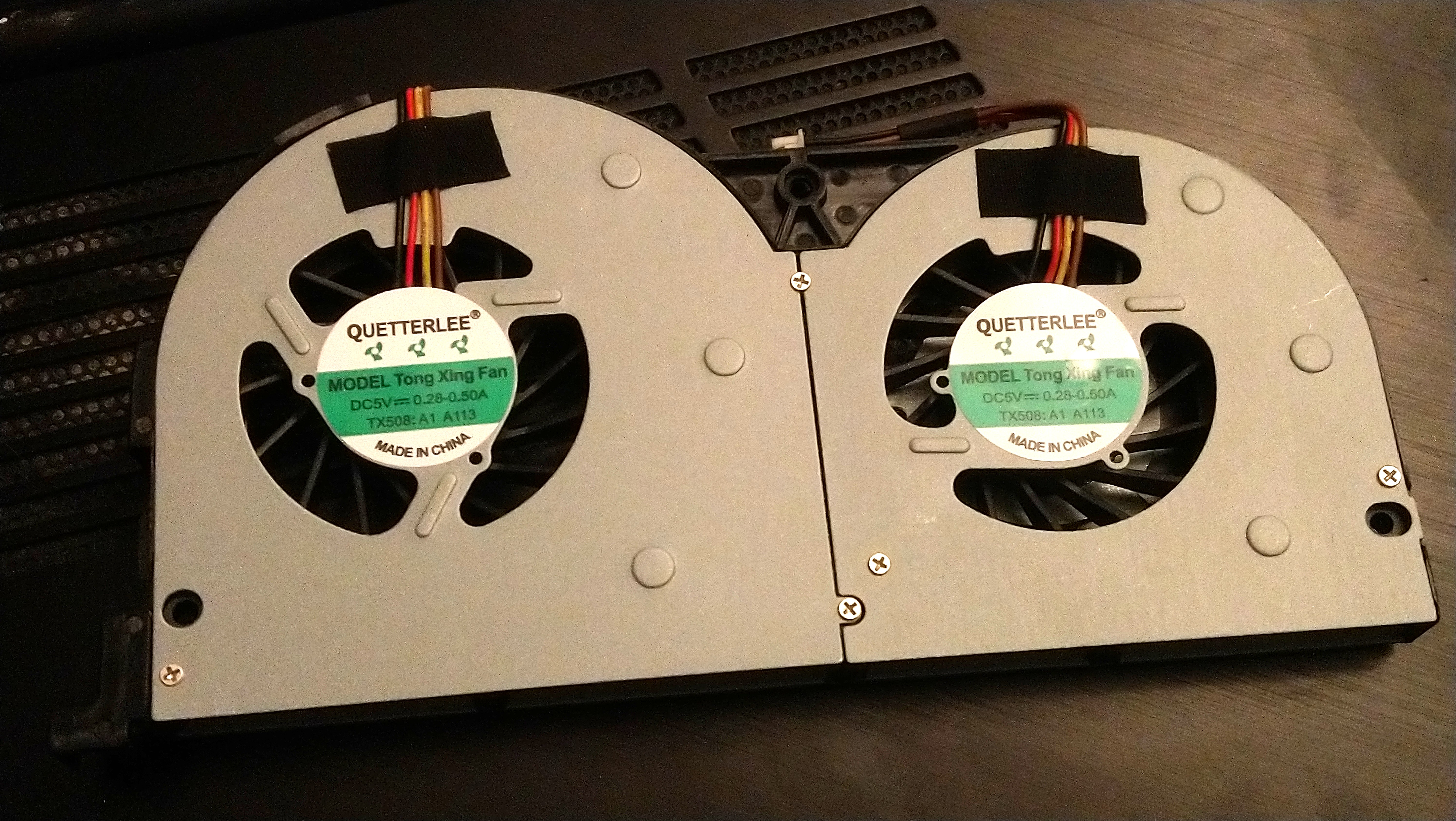

Got the replacement fan yesterday. Its label is different from Amazon product photo (see below). But looks like an exact replacement. The specs are:
QUETTERLEE
MODEL Tong Xing Fan
DC5V 0.28-0.50A
TX508: A1 A113

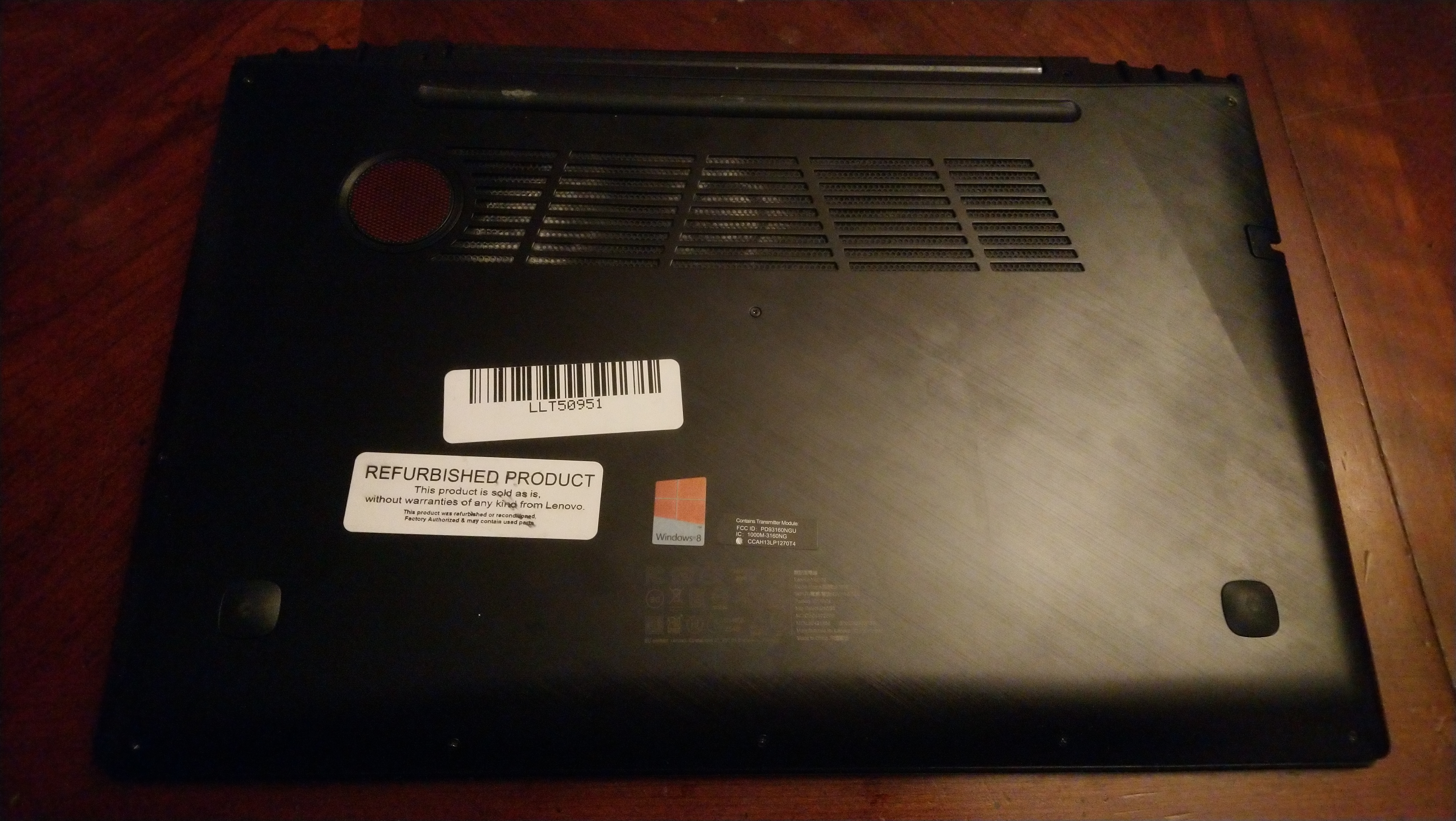

There are 10 screws under the Y50-70 laptop that needs to be removed. A Philips precision screwdrive will do. There are 5 screws at the bottom, 2 screws at the top corners, two on the side, and 1 in the middle.
