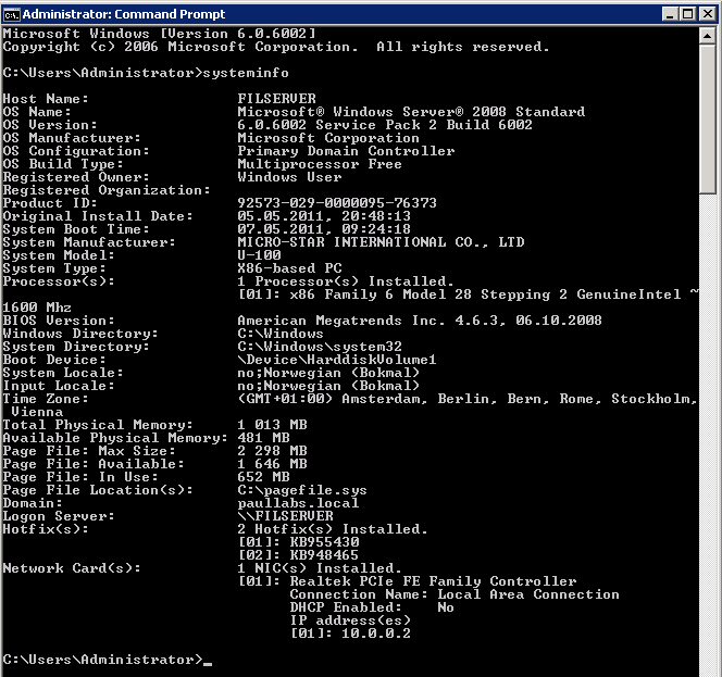

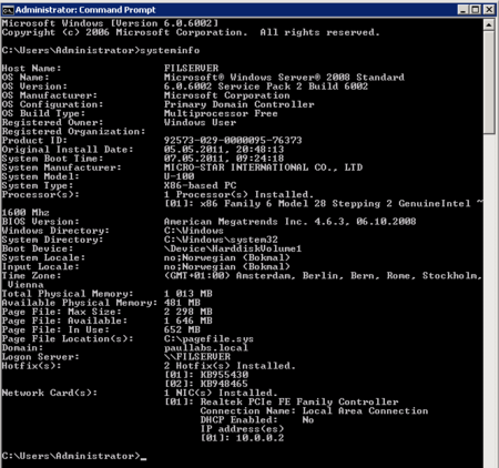

For the record, i've sucesessfully installed a 2008 server on a u100. Everything execpt NIC works out of the box, but just google the rlt8101 PCIe driver for vista/2008. Works like a charm for DC, DNS, DHCP and fileserver. Havent had any real issues yet! Perfect for a home where you have a few laptops or ipads or whatever. Good luck
PaulKemp
