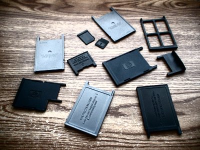

I have quite a few of these protectors from my collection of old laptops, PDA's, handheld PC's, and other electronic devices. I even have CompactFlash, SD Card, and miniSD Card slot protectors (see photo below). I have never thought of a good use for these cards. Now they will serve a noble purpose.

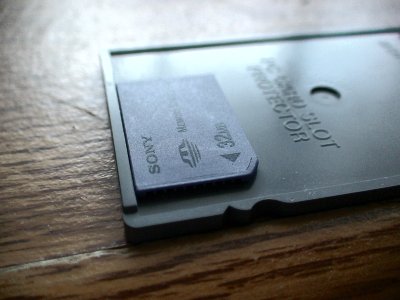

On the other hand, if you use Memory Stick Duo's, they will fit just fine with a solid protector tray (see photo below).

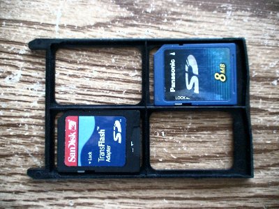

It turns out that the best protector to turn into a memory card carrier is the one that came with my Toshiba notebook computer. It has four compartments that are perfectly sized for SD Cards and Memory Stick Duo's. But the protector has to be turned upside-down. See photo below.

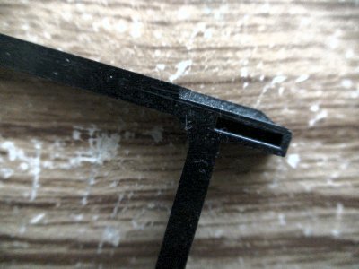

One catch is that the protector has protection tabs to prevent you from inserting the protector into the notebook upside-down. The photo below shows the tab. On a real PCMCIA card, that make sense, because you don't want to damage the interface connector inside the laptop computer. But for a protector card, it's useless.

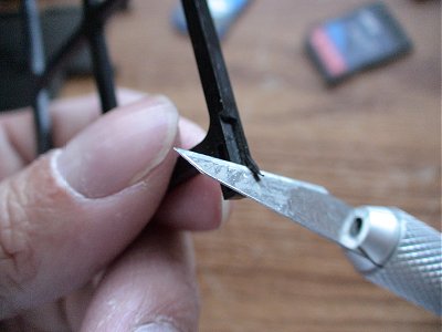

Using an X-acto knife, you can easily slice off the tab, as shown in the photo below. But be careful, you don't want to slice into your tender fingers.
