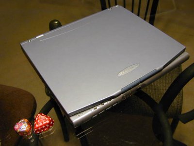

The Averatec 3120V notebook was originally a practical replacement for my Sony VAIO PCG-505TS SuperSlim notebook. The Averatec 3120V is a good replacement because it's slim. It's not as slim as the Sony SuperSlim, but it's much slimmer than any other notebooks on the market at the time. Sony at the time also couldn't make the SuperSlims any more because mobile CPU/fan have started to increase in physical size to meet performance requirements. Since then, I have passed on the Averatec 3120V notebook to my wife. And recently, the notebook had been really slow, trashing the hard disk all the time. So it's time for a memory upgrade.

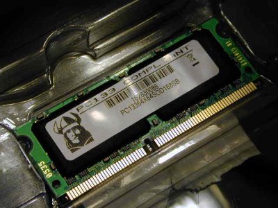

When I first bought the notebook, I had put a 256 MB memory upgrade into it to bring it up to 320 MB from its orignal 128 MB. I knew Windows XP is a memory hog and needed at least 256 MB to even perform basic tasks. The Averatec 3120V notebook has only a single memory expansion slot for an 144-pin PC133 SODIMM memory card. The manual had claimed that the largest memory module it supports is 256MB. But later, I found out that it would work with a 512MB memory stick,which is the largest memory card available in this form-factor.

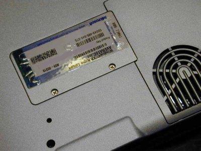

Under the notebook, by the fan vent, there is a rectangular cover with two tiny silver screws (see photo below). That cover is the memory upgrade bay cover. Use a small Phillips screw driver to unscrew the cover.

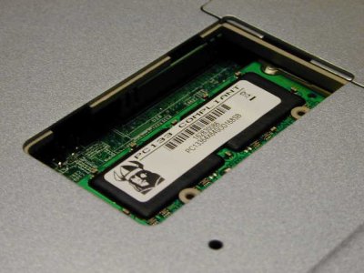

Using a small flat-head screwdriver, remove the memory bay cover to reveal the memory module below (see photo).

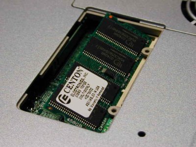

Step 2: Removing the Existing Memory Module

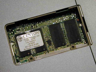

The memory module is secured with to metal clips on each side. use your fingernail to pry the two metal clips outward. The memory module will spring upward when the metal clips lose hold as shown in the photo below.

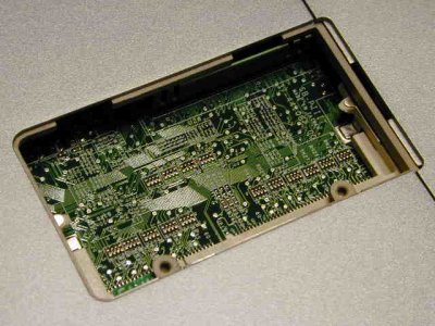

Once the memory module is loose, hold the memory module at the two edge and remove it from the memory bay. You'll end up with an empty memory bay as shown in the photo below.

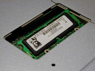

After inserting the memory stick into the slot at an angle, push the memory module down. The two metal clips will click into place when the memory module is down all the way.

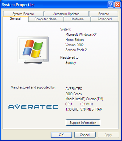

Finally, replace the memory bay cover and fasten the small silver screws. Plug your notebook in and turn it on. In Windows XP, you can see how much memory is installed by right clicking on "My computer" and then select "Properties". The screen capture below shows that I have 576 MB of RAM installed. The other 64 MB of RAM is being used by the graphics adapter.
