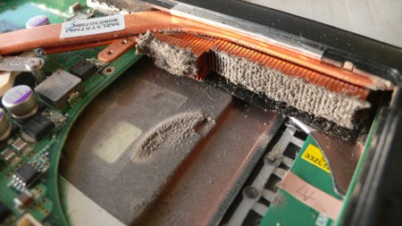

The number one reason that notebooks fail is because of dirty fan ports. When the air exhaust holes are clogged, the notebook CPU/GPU overheats, and the motherboard shuts the system down. The photo below shows a completely clogged heat sink holes that prevented this Acer Aspire 3004WLMi from functioning. Once the lints are cleaned away, the notebook ran fine.

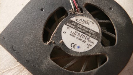

After cleaning the exhaust port, be sure to clean the fan as well. No doubt the lint are sticking to the well worn fan (see photo below). You might want to replace it altogether.
The Acer Aspire 3004WLMi has a DC brushless fan. It's model number is AB6505HB-E03. It's a 5V fan that draws 0.25 amp of current.
Once you have the fan's model number, it's quite easy to find replacement parts on the Internet via a search engine, like Google search.
