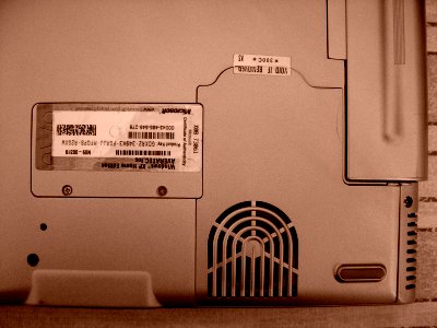

Before we can source a fan, we need to find out what fan it is. And we can only do that by disassembly the CPU compartment. First thing to do is to look at the bottom of the notebook and find all the component covers. On the Averatec 3120V notebook, you can easily spot the CPU and fan cover by the circular vents (see photo below).

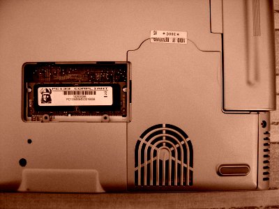

On this notebook, we can only pry open the CPU/fan cover after removing the memory cover. There are two small screws that can be easily removed with a Phillips mini-screwdriver. Remove these screws to reveal the memory module (see photo below).

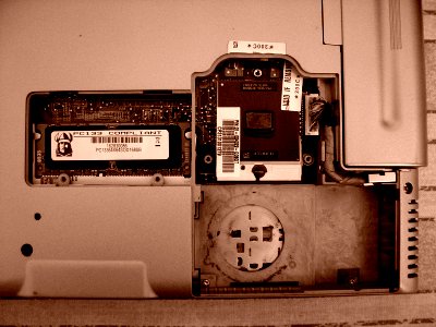

Once the memory upgrade cover is removed, the CPU/fan cover can be pried open. Insert mini-flat-blade screwdriver into the slot between the CPU/fan cover and the memory upgrade opening to pry the panel open. After removing the cover, the CPU fan and heat sink is exposed as shown in the photo below.

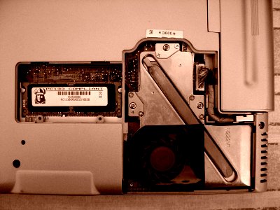

To remove the fan on the heatsink, use the mini-Phillips screwdriver to unscrew the three larger screws on the heatsink. These three screws are under spring tension. So you have to take turns unscrew them repeatively until they are all
unscrewed. Once the heatsink is loose, you can remove it (see photo below). But be careful, the fan wires are still attached to the notebook.

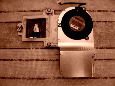

The following photo shows the underside of the fan and the heatsink.

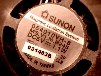

The following photo shows the fan label with the manufacturer and model number. It's a Sunon 054010VH-8. A quick search on Google showed that Allied Eletronics sells this fan for $18.27. I just put in an order. I will keep you posted on the result when the fan arrives.
