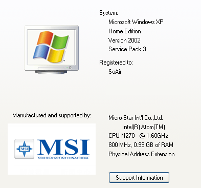

At first, I couldn't figure out why pressing Fn-F10 doesn't do anything on my MSi Wind. Then I realized that it's because I am running on AC power. Once I unplugged the AC Power, the Turbo Battery Mode works like a charm. I have BIOS version 1.06. Attached below is a screen shot of what the processor is running at normally.

The following screen shot shows that the processor runs at 800 MHz in Turbo Battery Mode. The screen also dims and the power setting changes to "Max Battery".
