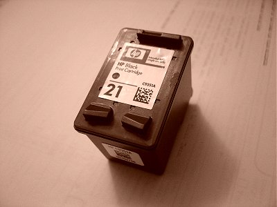

Inkjet print cartridges costs a lot of money. And recently, they've become smaller and smaller. Take, for example, my brand new HP Deskjet D1341. I just put this printer into service so I can print out all my tax return forms. After printing this year's return, a return from last year, and a few other things, the print cartridge is already empty.
The HP Deskjet D1341 uses the HP Black Print Cartridge 21 (C9351A), shown in the photograph below. This ink cartridge seems to be half the size of the previous generation cartridges.

So, sitting here at midnight, half-way printing through last year's tax return, the ink cartridge is out of ink again. Rather than driving out to Wal-mart in the middle of the night to pick up a new cartridge, I decided to play around with it.

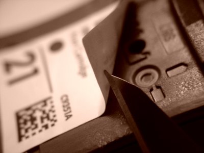

I used an Xacto knife to peel back the label on top of the cartridge. And viola, the ink filling hole is revealed (see photo below).
What ink to use? I happen to have a pack of Universal Inkjet Refill Kit in my office. Those are usually good bets.
Well, what do you know? As I'm finishing this post, my 24 page tax return just finished printing using the new refilled ink. The document looks flawless.

Note it's the hole in the center - I already started drilling in the corner niche before I looked at the picture more closely.

Hi Thanks for the info. I have been drilling out another hole and this sure looks faster and cleaner. I just peeled back the label on a 97 color and there are three openings for the three colors. Sure beats drilling out three holes.

BRILLIANT! Thanks for the great tip and screenshots! I don't know why but the refill pack I bought instructs to fill the top right of the four holes in the catridge....Was about to try and drill a hole in my cartridge!:P
