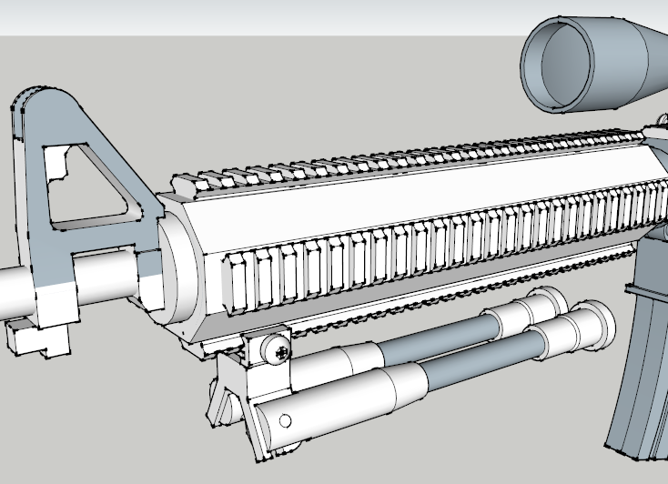

Hi all. I've been using SketchUp to edit models. And I've come across a model where there are marks at the end of each end point. I attached a screen shot below. I've tried changing all of the options under View -> Edge Styles (Edges, Back Edges, Profiles, Depth Que, and Extension). But none of the options gets rid of those marks. I'm out of ideas. Could anyone help me out? Thanks.

Ok. Figured it out. It's in "Windows" -> "Styles". Under the "Edit" tab, disable "Extension" and "Endpoints".
