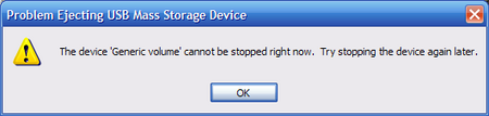

I have a lot of USB hard drive, flash memory cards, and other removable storage sitting around my computer. I connect and disconnect them all the time, depending on what data I need. Over time, I've learned to click on the "Safely remove USB Mass Storage Device - Drive(F:)" in Windows XP before actually unplugging a removable drive. However, sometimes I get the "Problem Ejecting USB Mass Storage Device" error dialog (see screen shot below). The dialog always says, "The device 'Generic volume' cannot be stopped right now. Try stopping the device again later."
This error dialog always gives me a headache at first, because I am forced to shutdown my computer and start over. But soon I learned the conditions that are giving me the error, so that I can change the condition to remove the drive without restarting Windows. The following are some of the conditions I know about:
  1. Hard drive is sleeping; being spun up. With some removable drives, the hard drive might spin down due to inactivity. When you try to "safely remove the drive", the drive is forced to spin up. During spin up, the drive is not ready and Windows XP is too impatient to wait. Try to "safely remove the drive" again after spinning up resolves this issue.
  2. Windows Explorer is showing the directory content on the drive. When any directory content is being displayed, Windows Explorer locks the drive so that it can't be un-mounted. Change Windows Explorer to a directory that is not on that drive usually solves this problem.
  3. Command Prompt is in a directory on the drive. Believe it or not, some of us are still using the Command Prompt. If your Command Prompt is currently in a directory on the drive, the drive is again locked. Change directory to another drive or exit Command Prompt to resolve this conflict.
I've listed several reasons why you can't unmount a drive in Windows XP. If you know of any other conditions, please feel free to share with us.

I should mention that if all else fails and you can't safely remove the device no matter what you try, then it's time to shutdown the computer. 99% of the time, that will safely un-mount your device from your computer. When your computer is off, you can unplug your device.
