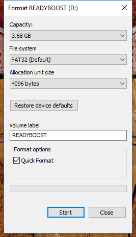

The two hard drive looks the same, just formatted differently. You didn't specify what operating system you are using. But if you use Windows, you just have to reformat the hard drive using a different sector size.
In Windows, right click on the drive and click on "Format...". Then you can select the "Allocation unit size" as shown in the screen shot below.
