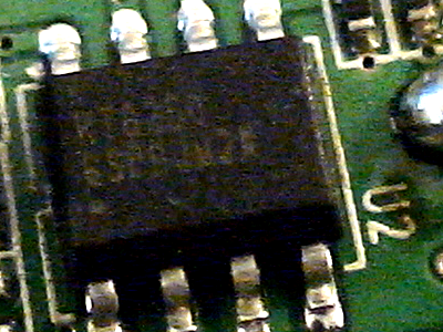

Hello, can someone with the OASiS DESKTOP 1607P REV B board tell me what is the model number of the 8-Pin IC located just behind the DC Jack?
The part number designation is U2.
Thanks
Agent24
Wed, 03 Aug 2011 05:58:00 +0000
It's too small for me to read. So I shot a photo of it with my camcorder and enlarged it on my computer. It helped slightly, but I still can't make out what it says. I've attached the image below. Maybe you can make out what it says.
Sun, 07 Aug 2011 01:03:21 +0000
My WD1.5TB external drive (with WD1501FASS Caviar Black) has Oasis Desktop 1607P USB/SATA board showing RevB 4060-705078-001.
The U2 chip is labeled -
MSC
7101IMD
*043B * This character (before 043B) is unreadable or is simply a "dot".
Used old-skool magnifying glass! :-)

for the U2 Chip : mine is MSC 7101IDM 047G
U3 : APM4532 RN13U
U4 : Winbond 25X10BVNIG 1110
U1 : INITIO INIC-1607P C11 E46280111 1108
Fabrice
Tue, 30 Aug 2011 08:42:07 +0000
The U2 chip looks to be a standard I2C EPROM chip. It might contain information on the drives it's supposed to connect, and that would mean the adapter is simply hard-coded to fail in case the drive's ID does not match the ID string programmed in the EPROM.
If someone could read out the EPROM we may be able to find out something more. I wouldn't be surprised if there was a string in there that reads "WD20EARS" with some kind of revision number. Which means the enclosure should be straightforward to hack to other drives just by reprogramming the EPROM to match the drive ID string.
Stoney3K
Tue, 30 Aug 2011 11:58:38 +0000
U1: INIC-1607P - SATA to USB Bridge Controller IC - http://www.si-tech.co.jp/eng/v-ini.php
U2: MSC 7101IDM - 2A High Voltage Synchronous Buck Converter - http://www2.microsemi.com/datasheets/NX7101_DS.pdf
U3: APM4532 - Dual Enhancement Mode MOSFET - http://pdf1.alldatasheet.com/datasheet-pdf/view/93445/ANPEC/ . . .
U4: 25X10BVNIG - 1-Mbit SERIAL FLASH MEMORY WITH 4KB SECTORS AND DUAL OUTPUT SPI - http://www.ic-on-line.cn/view_download.php?id=1437791&file=0 . . .
U4 is used as ROM for U1 and stores firmware for whole OASIS DESKTOP 1607P device. So probably here we have our problem. U4 is flash so it should be easy to reprogram it with some other firmware.

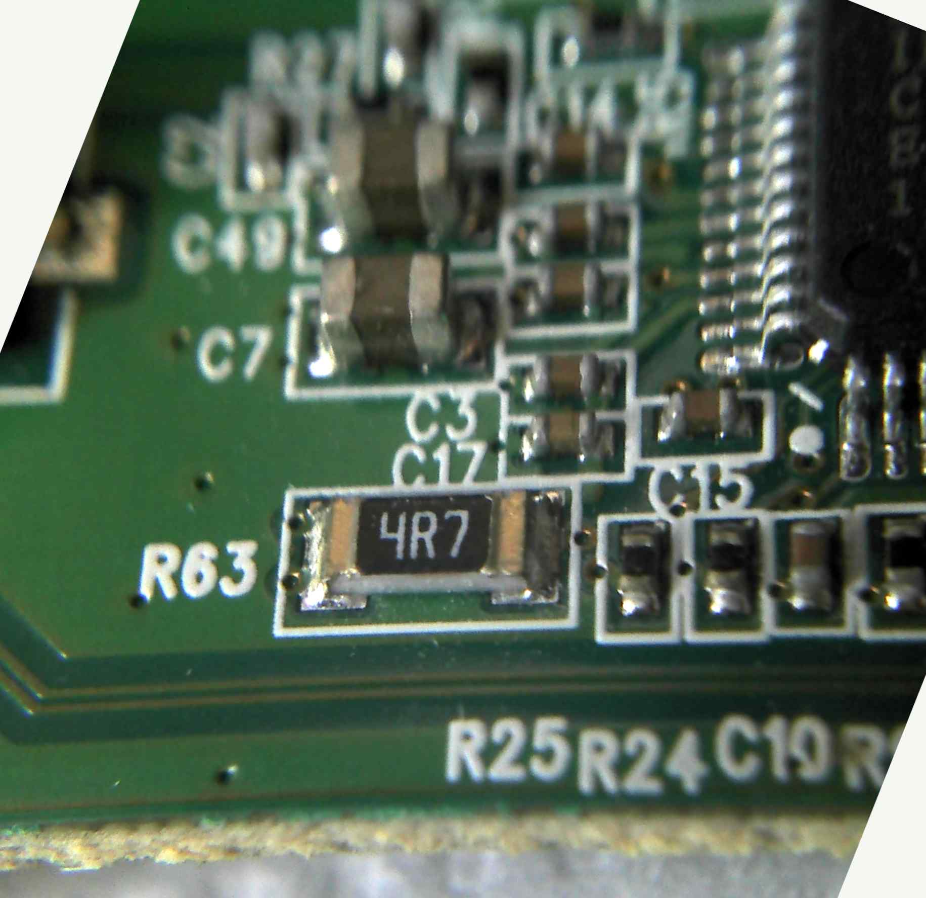

Hi
I read some of u opend the case.
can somebody tell me what the value of R2 is.
It got fried in the case of a friend of mine he asked me if I could repair it
and it seems like that just the Resistor was blowen apart.
I thougt it might be worth a try.
So if somebody could tell me the vallue it would be great.
Thx
Virsing
Fri, 02 Mar 2012 22:39:19 +0300
Sorry for my doublepost.
But I named the false Resistor.
It is R63, right of the Osszillator.
Thx
Virsing
Virsing
Fri, 02 Mar 2012 22:53:25 +0300
R63 on the Oasis Desktop 1607P is 4.7 Ω (= 4,7Ω).
Simon
Wed, 28 Mar 2012 20:13:10 +0400
Hi
took a while for me to remember :-D
Thanks, will try it tomorrow!

Hi. This is the only site that helped me, so I decided to write here about my result
My sister's children dropped the WD Ext HDD 1021 USB Device, after which it stopped working. I bought a new 500GB disk, connected it to my laptop via a USB 3.0 adapter, checked, created partitions and then inserted the USB Device into the WD Ext HDD 1021 instead of the faulty disk, but Windows 10 did not see the partitions. After opening the disk management manager, I received a request to initialize the disk. I confirmed it, but was denied access. Next, I booted into the LiveCD from a USB stick, but no programs there had access to the disk either
Later, I counted the firmware from the flash memory from the Oasis Desktop 1607P board, but I found new firmware only on closed forums, from where I could not download them
I tried connecting other drives to OASIS. Seagate didn't even spin up, but just the LED was blinking. Other WDS of different capacities were also defined without access-denied partitions.
Next, I found this website and a description of my problem. I reconnected my new 500GB WD to a USB 3.0 adapter. We've seen each other. Next, I booted from the LiveCD and launched Low Level Format for full formatting. (I found information here above that it was possible to do quick formatting). Then I moved the WD 500GB to the WD Ext HDD 1021 USB Device and access appeared. I've opened the partition and the disk is working fine.
If you do not have a LiveCD, it might be possible to erase the disk "0" with the help of the Victoria 5.35 program by checking the disk for erasing from DDD. It might help to simply delete all partitions before connecting to the WD Ext HDD 1021 USB Device, but I don't want to experiment anymore. So I lost a lot of time.
Thank you all!
