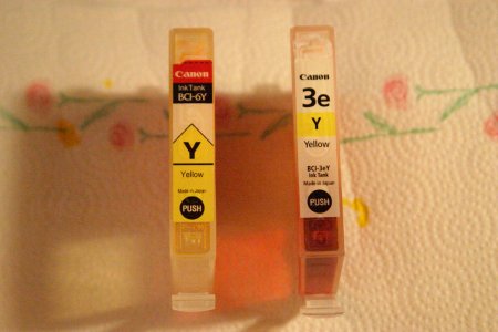

Canon BCI-6Y and BCI-3eY ink tanks are exactly the same!
My Canon S820 inkjet photo printer ran out of the yellow ink lately. This is a really nice printer with Canon Think Tank System that has six separate ink tanks: black, photo cyan, photo magenta, cyan, magenta, and yellow. The yellow ink tank model number is BCI-6Y. However, I just can't find this ink tank at any of the local stores.
While setting up the Canon PIXMA iP3000 Photo Printer for my wife, I noticed that the yellow BCI-3eY ink tank is very similar to the BCI-6Y ink tank for the S820. Upon comparison, they turned out to be exactly the same. From the top, the only difference is the label. One says BCI-6Y while the other says BCI-3eY (see picture below).
Sat, 25 Jun 2005 00:35:04 -0700

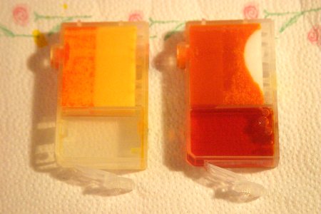

From the side, the two cartridges look identical physically (see picture below). The color of the ink looks a bit different, but it could be that the newer, full cartridge just has a higher concentration of the yellow ink. It's common for brand new cartridge to appear to contain different color ink than specified on the label. The BCI-3eY ink cartridge on the right is a perfect example. It's obviously a yellow ink cartridge, but the ink looks orangish-red in color.
Sat, 25 Jun 2005 00:38:31 -0700
Desperate for the yellow ink tank, I plugged the BCI-3eY into my Canon S820 photo printer and it click right into place. The printer accepts it as well after I closed the printer cover. I was able to print a few test sheets and the printer seems to be working just fine. I just hope the color is exactly the same as the BCI-6Y ink tank; I don't want colors in my pictures to be slightly off.
Has anyone else tried this same trick?
Sat, 25 Jun 2005 00:42:01 -0700

Hmmm. Very interesting. I could see no mechanical difference between the two cartridges either. I hope it's not your print head that has failed.
