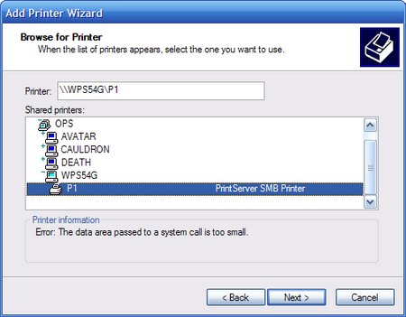

It didn't work. I removed all of the HP software and installed the HP Basic Driver. But when I tried to add the printer, I got "The data area passed to a system call is too small" error message (see screen capture below). Anyone know how to get around it?

Ok, I finally got the HP D1341 printer to work with the Linksys WPS54G. It turns out that you must run the Linksys Setup Wizard. You can't simply select the printer via "Add a printer". The Linksys Setup Wizard will set-up the printer on a "Standard TCP/IP Port" and copy the necessary files to your computer.
Sat, 07 Apr 2007 13:46:39 -0700
Ok, I just had to go through the entire install process again for my wife's notebook computer. It turns out that you have to "Add a printer" first, before the Linksys print server software will even let you associate its driver to the printer driver. Around and around I went until I finally got it to work.
