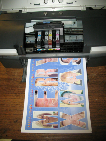

I can't promise it will work on all printers with dedicated photo inks but my old faithful Canon i950 does produce acceptable half-tone results, if not meeting professional standards. To support my point, here are two pics - one with the photo magenta cartridges fitted and one without; the print-outs speak for themselves (subject to limitations of the Net, of course.
Try it yourself, Vinna -- if the photo inks cost as much as they do in UK, you can save a lot of money!

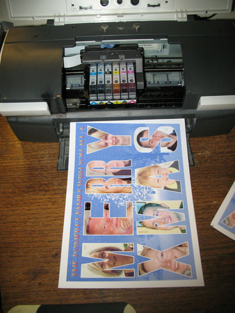

... and here is the other pic.
