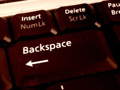

The BTC 6100C multimedia keyboard has a very small footprint that doesn't take up much desk space. And I got it quite inexpensively at the local Fry's. I use it all the time with my desktop computer. The layout on the keyboard is perfect, except for the Insert and the Delete key. For some reason, BTC swapped the two keys relative to the norm. It has troubled me for a long time, so I am going to swap them.
But before I swap them physically, I need a way to swap them in Windows, which is the operating system I run on my desktop. That is where this Insert Delete Swapper program comes into play. Insert Delete Swapper is a small Windows utility that swaps the Insert and the Delete keys on your keyboard. And it's free. I can put this utility in my Startup folder and have it start up every time I start Windows.
Now that I have the software working for me, it's time to modify the hardware. Simply pop-off the two keys. It's easies to pop them off from the bottom. Then snap them off from the top.

After you popped them off, you can snap them back onto the keyboard. Just swap their positions. When you have the key aligned right above the key mechanism, firmly press down on the key until it snaps into place. Then you are all done. And the Insert/Delete keys will be swapped as shown in the photo below.
