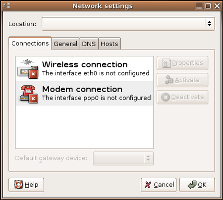

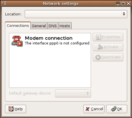

Ubuntu has a "Network settings" dialog that can help you set-up your network. You can open it by going to "System -> Administration -> Networking". However, the Proxim RangeLAN-DS 802.11b Wireless LAN PC Card did not show up on the "Connections" list (see picture below). If your network card showed up on this list, then you can skip this step. Otherwise, read on to see how to set-up your hardware.

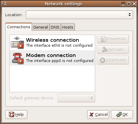

Upon reboot, Ubuntu found the wireless network card successfully as indicated in the picture below. Once Ubuntu recognizes the wireless network card, it's time to configure the connection.

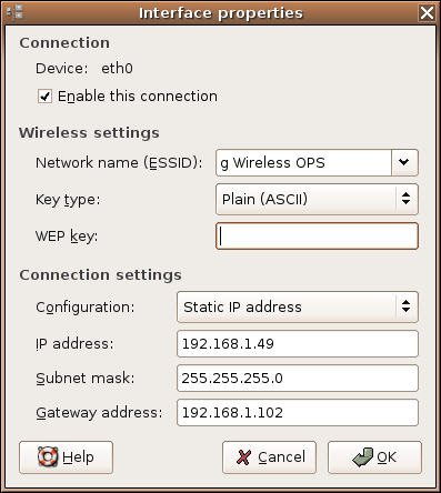

Click on the "Wireless connection" item to select it. Then click on the "Properties" button, which will now be enabled. An "Interface properties" dialog box will pop up on your screen. Most of the GUI widgets on the dialog will be disabled and blank. Click on the "Enable this connection" checkbox to enable the dialog. Then fill in the detail for your network. An example of the "Interface properties" dialog box filled in is shown below. I found out that the "Network name (ESSID)" is case-sensitive, so make sure the case matches your wireless access point.

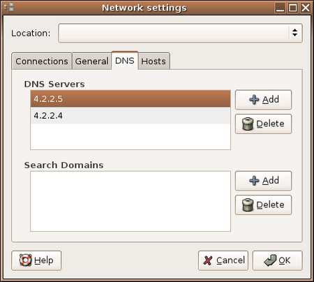

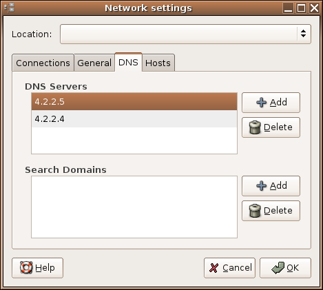

After configuring the network interface, click on the "OK" button to store your settings. Then click on the "DNS" tab in "Network settings" dialog box. If you are using DHCP, then you can skip configuring the DNS Servers. Otherwise, add your DNS Server addresses using this box. An example is shown in the picture below.

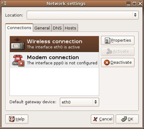

When you are done, click back to the "Connections" tab. Select the "Wireless connection" item again (see picture below). This time, click on the "Activate" button to activate the wireless network on your computer. Now you can get on the network once again.
