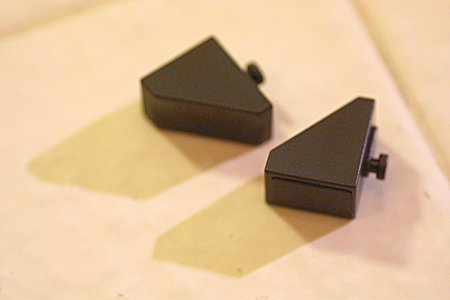

The WBA11B comes with these two wedges . . . I have no idea what they are for. They don't seem to attach to anywhere on the WBA11B itself. They are shown in the photo below. Let me know what they are for.
